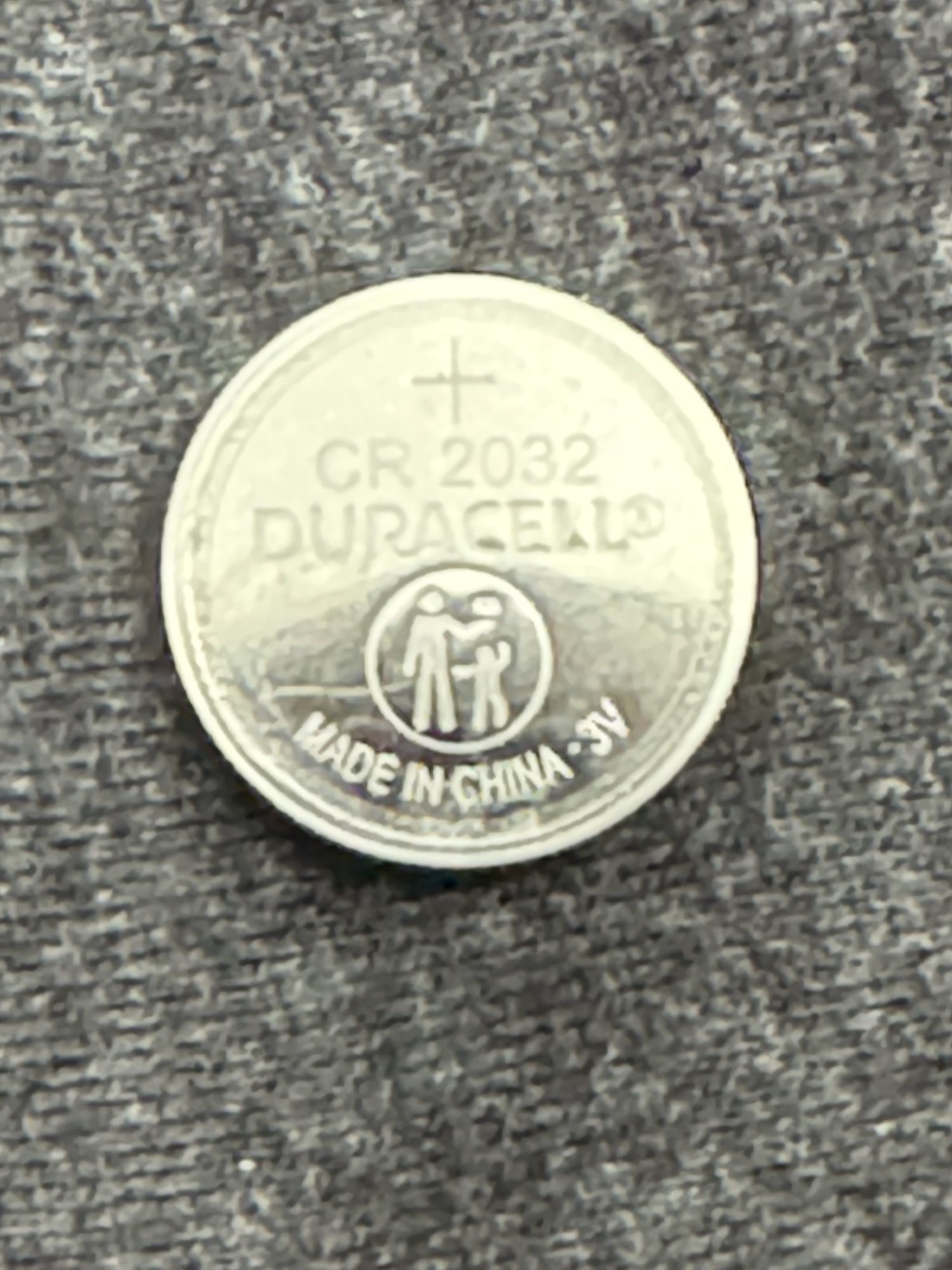

Also, for those not aware, Duracell changes the placement of the bitterant ring from the negative side (which is what was causing the issue) to the positive side. My AirTags came with Duracells with this updated placement and I’ve also verified with batteries in retail packages marked “compatible with AirTag”. The attached picture is a battery from one of my AirTags.

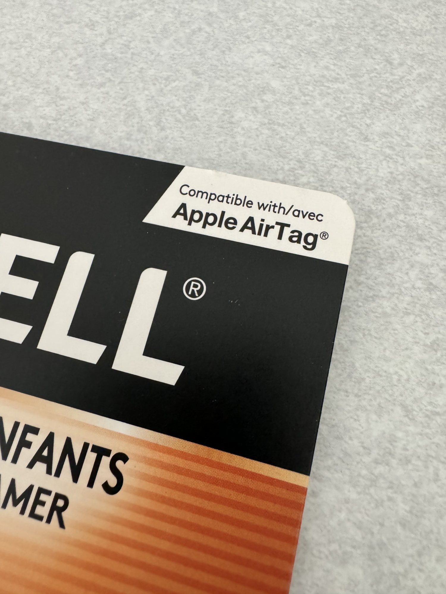

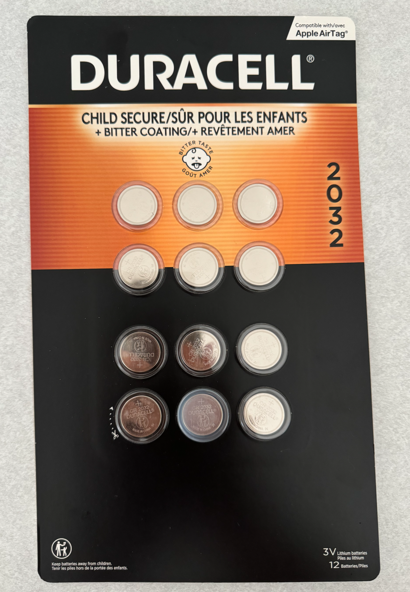

The Duracell batteries never worked for me. But I just spotted the updated ones at Costco. The packaging says "Compatible with Apple AirTag" right on it. Confirming that it now works!
