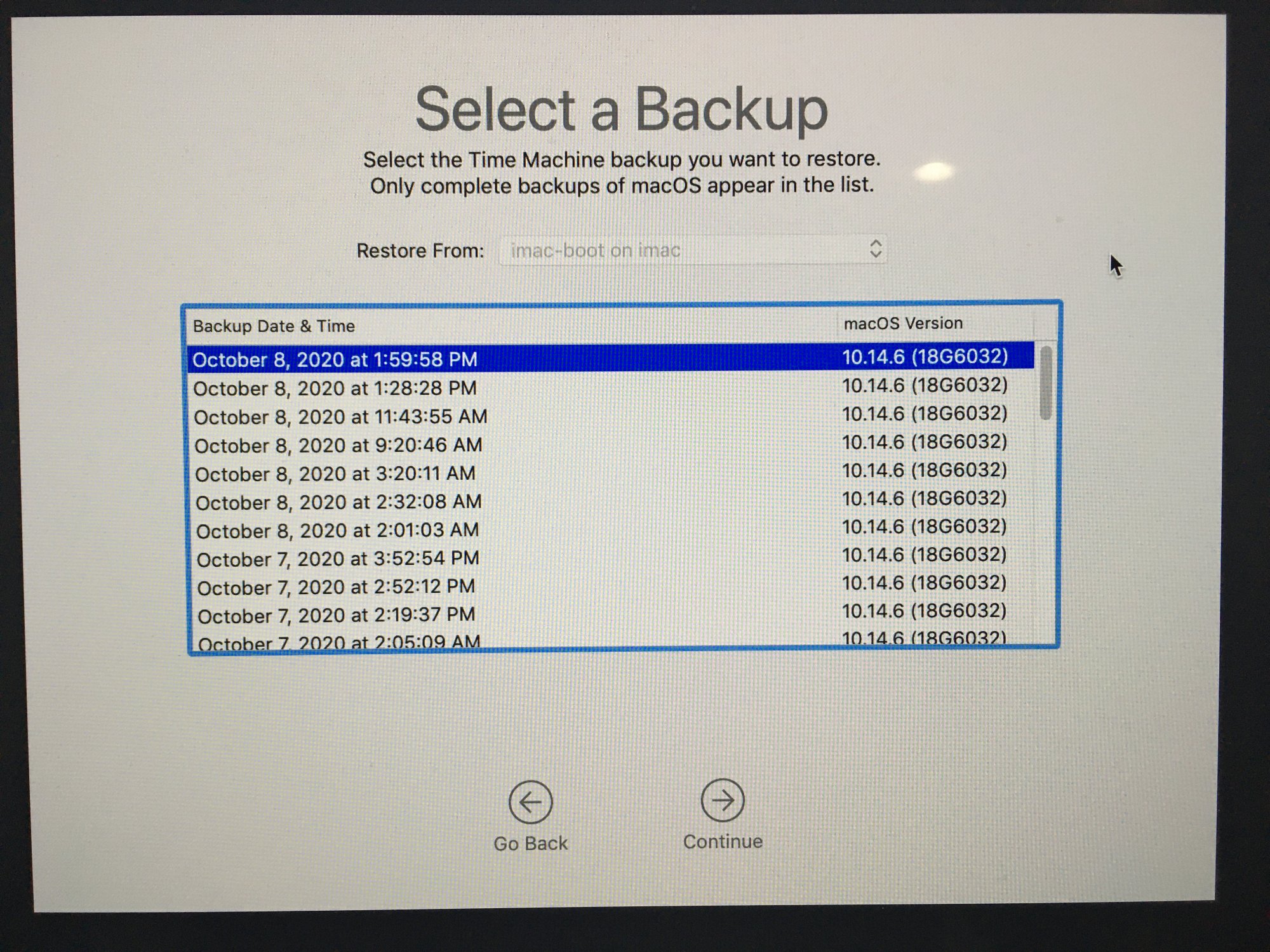

I looked on my Mojave system, and it looks to me like the "Reinstall macOS" option in Recovery Mode will only restore your system volume (normally your internal drive). There appears to be no way from that screen to restore other volumes (e.g., external disk drives/partitions) that were backed up along with the system volume. Presumably you are intended to restore these extra volumes after you've booted up with the newly-restored system volume by using the usual Time Machine interface.
My TM backup includes one internal (boot) volume and several external drive volumes. Booting to recovery mode and selecting "Reinstall macOS" eventually gets you to the screen I show below. The drop-down labeled "Restore From:" is disabled/grayed out (i.e., I can't select anything else), I think because I had backups of only one bootable system volume. (One could have bootable macOSes on external volumes included in the same TM backup, and I guess they would show up here, but that's an unusal case.)
Note that my machine name is "imac" and my internal system volume is named "imac-boot". Most people's "Restore From" selection would read "Macintosh HD on <machinename>".

Thanks for checking into that. I’m a bit confused though. First, it was my understanding that only choosing “restore from time machine backup” in the macOS utilities window would get you to the screen in your screenshot, and that choosing “reinstall macOS” restores the os from the internet from scratch. Do you remember the options you saw after you chose “reinstall macOS”? I haven’t actually done this process yet.
Also the issue OP had was that when restoring the internal boot drive, it would try to cram the entire backup (from both the previous internal boot drive and an external storage drive) onto the new internal boot drive. Are you saying that choosing the “reinstall macOS” option and then (somehow) choosing to restore from a time machine backup from there will extract only the backup of the internal boot drive to restore to the new replacement drive?
I’m sorry, I made a mistake in my posting. I had actually chosen “restore from time machine backup”.
I did not actually do the restore, but I don’t think I would have gotten the disk space problem because the Restore From field specified a single volume, not all volumes in the backup. But I could well be wrong!

Oh ok. Yeah that does seem to indicate it will only restore the boot drive and not the external data. That would make sense. Curious what the OP’s issue was then. Maybe he/she had more data on the boot drive than he/she thought.
