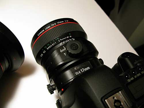

TS-E 17mm €2499

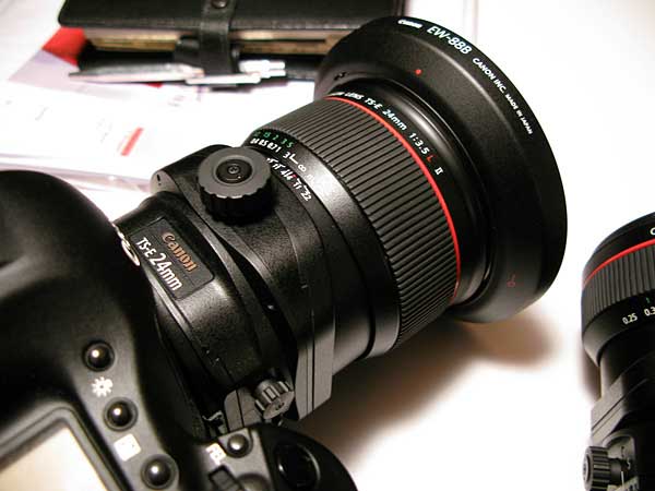

TS-E 24mm €2299
Seems kinda pricey, but these are very specific lenses.
I was stalling on the 24mm TSE as a few reported the quality to be a little suspect. The new one should address that, mind you the 17mm looks good (apart from the price). Maybe i'll hire it first.
