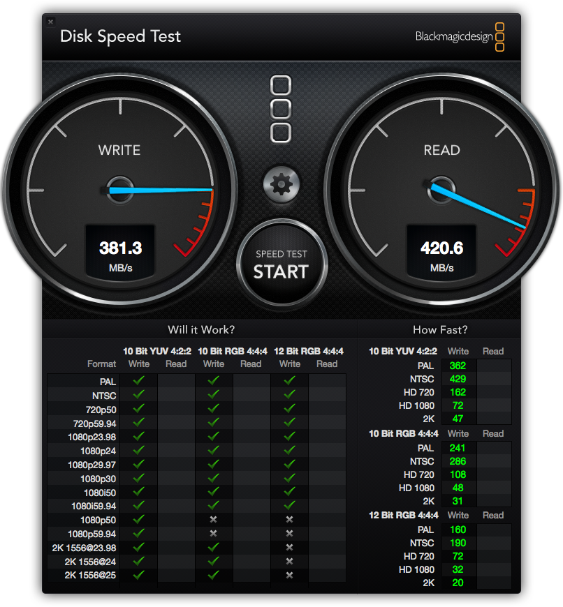

I have been using the Dell U2715H for a few weeks now and have been running my iTunes and photo library off of a USB 3.0 SSD drive flawlessly connected to the monitor. I've also have my time machine backup drive connected as well and can charge my iPhone/iPad with no issue. A really great monitor in my opinion. Here is a screenshot of the USB 3 speeds on the SSD.

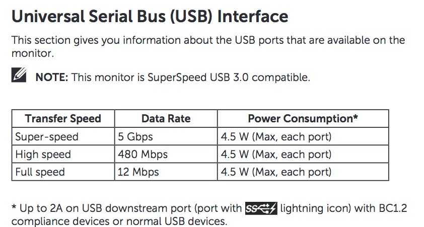

Thank you! Glad to hear that this has been working well. I'm assuming based on your description that all the USB 3.0 ports on the monitor are powered (and not the just the "high-powered" one). Is that correct?
Correct. The "high powered" port is the one on the back. Here is a snippet of the manual:
