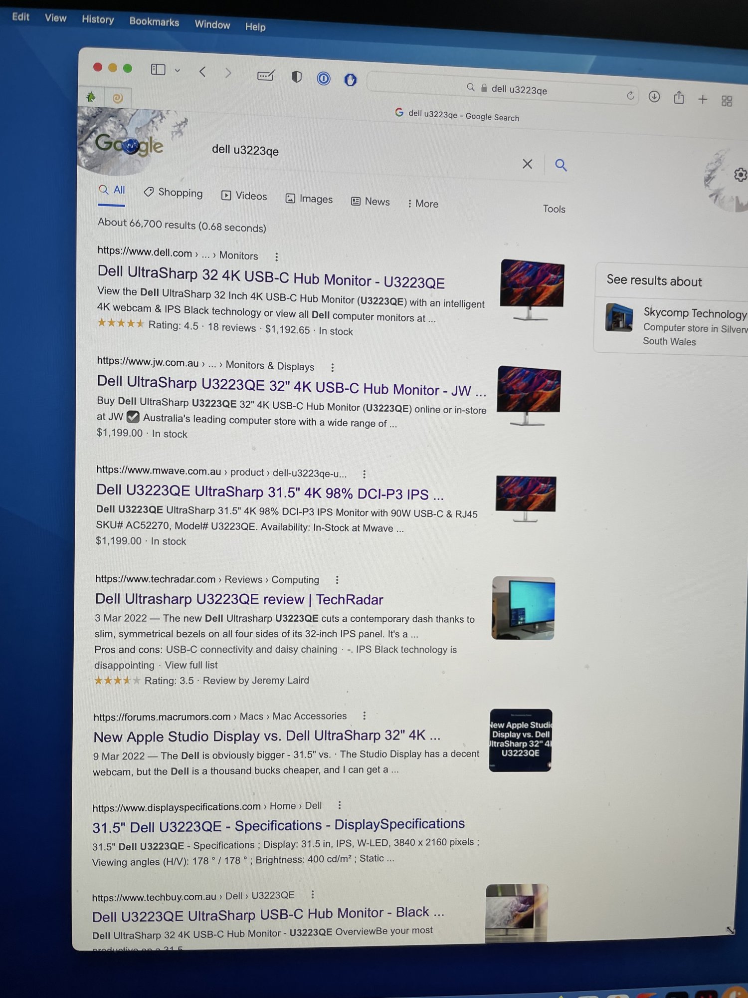

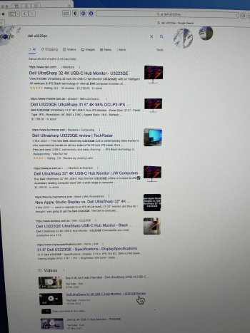

First image is taken (with a camera) of the iMac, second of the Dell.

You are having problems because macOS doesn't scale well with 4K screens since the DPI in larger 4K screens fall below 220 DPI. Since you are using a 32 inch 4K screen, Apple deems the DPI too low, thus you won't have full scaling options.
This article explains perfectly the scaling issues with 4K monitors larger than 24 inches. 4K is only really good for 21-24 inch 4K displays and larger screens run into issues with UI elements being too small or too big (27 inch will look good with 1080p scaling since 4K is two times of 1080P, but it will look big, but look like crap when scaled to 2K).
The best option is to take back the Dell Ultrasharp and buy a used LG Ultrasharp 5K, which will run around the same price as the Dell U3223Qe on EBay, but there are some issues some users have with that display.
Otherwise, you can just get a 4K 27" and run the monitor at 1080P scaling if you don't mind larger UI elements, but you are sacrificing screen real estate without sacrificing sharpness or drop down to a 4K 24" screen. This is why I stick with a non-retina 2K 27 inch monitors, although some people don't like how the text looks. As for me, for high DPI, 5K/6K are the only real options, but are expensive, although I do plan to get a Studio Display that I am still waiting for as a main monitor and the 2K as a secondary.

With the 32" model, you're only getting 139 PPI. Apples 5K display has 218 PPI, so naturally text is nowhere near as sharp.
I would recommend switching to the smaller U2723QE. You get 163PPI which makes a big difference. I received mine yesterday and when running it in "looks like 2560x1600" text is super sharp.
Have u tried different scaling options? It seems like to me you run the monitor with native resolution. A scaled resolution is better.
Otherwise it would be also worth trying out connecting the monitor over USB c instead of HDMI. As far as I understand, there is some limitation with HDMI only displaying 8 bit Color’s instead of 10bit.
