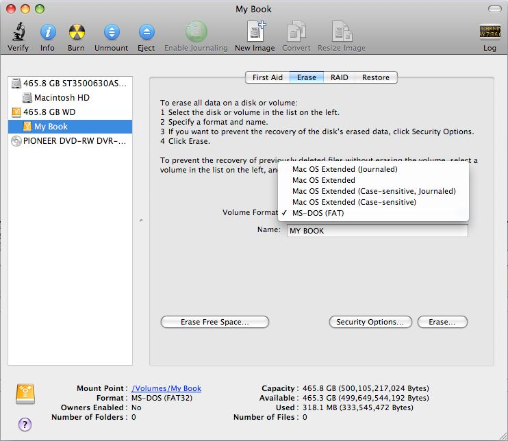

I just got a WD external hard drive that is FAT32. I understand that the Mac can read/write this format. Would you recommend that I change it to HFS+ or should I leave well enough alone?
If I do reformat, I guess this is done through the erase tab in the disk utility?
I have attached a screenshot.
Do I select "465.8 GB WD" or "My Book" as the drive I'm reformatting? Also, it looks like I can select "erase" or "erase free space." Which am I doing?
And I select the format that I want to change it to, not the format that it already is? Which of the options do I select (journaled, case-sensitive, etc.)?

You would select "465.8 GB WD" to reformat the whole drive or "My Book" for just the partition I think. You probably want to select 465.8 GB WD so you can start fresh.

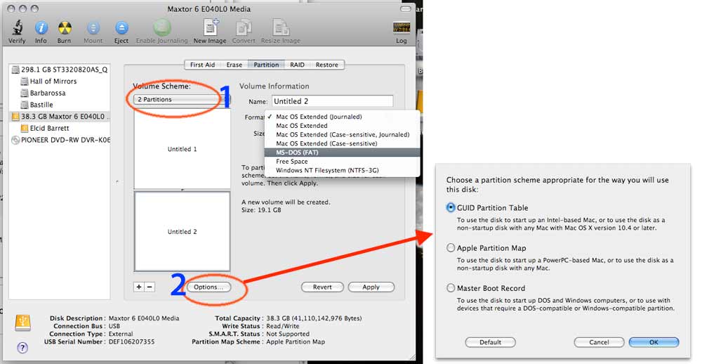

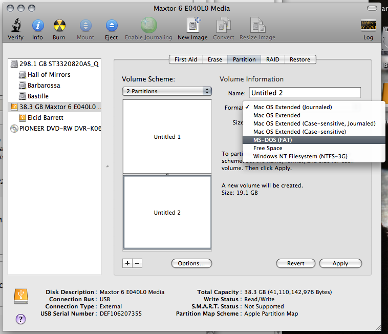

okie thanks for the advice. i do not how to format the whole drive to Mac OS Extended, but may i ask how do i format a part of it to FAT32? pardon me for the noob question..
Disk Utility:
Hope you don't mind me borrowing your picture and adding one part BlueRevolution. I'll delete it if you do.
I just wanted to add one thing- if you think you may ever want to use the Mac OS Extended partiton (partition 1 in BllueRevolution's pic) with a cloning program such as Carbon Copy Cloner or SuperDuper to make a bootable clone of your internal disk, you will need to double check one thing in addition when you originally partition the drive. Since we don't know what type of Mac you will be using this with meisyong, I can't tell you what choice to make but---
When you first go into the Partition section, first make the change as indicated to have the "Volume Scheme" section read "2 partitions" as shown. Then as step 2, click the "Options" button which will open a window as shown in the second pic. If you are using an Intel based Mac choose GUID there for bootability, and if you are using a PowerPC based Mac choose Apple Partition Map. Then go ahead with selecting each partition and defining what format each should use. From experience, make the FAT32 the last partition on the disk.
The only time this can be set (without erasing the whole drive and setting it up again that is) is at the beginning which I why I wanted to toss this in.
Not at all. That's a good suggestion as well. It can't hurt to choose whatever partition map is appropriate to bootability on your system, and as you say that can really help down the road. Even if you're not planning to boot from the drive, I'd pick the right partition map anyway.
