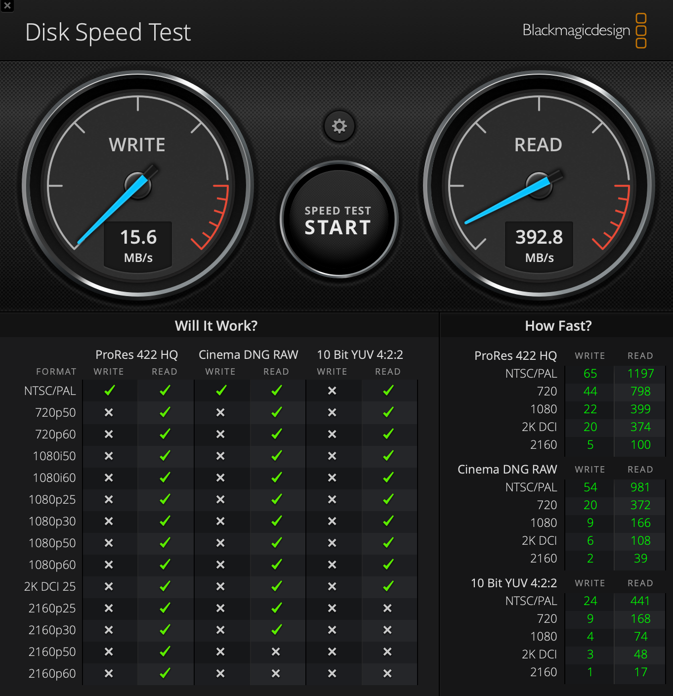

Freshly installed OS running on 1TB Samsung 870 QVO external drive that is capable of the Thunderbold port and providing 10GB in the enclosure. It should write at 520 and read at 540 but as you can see my write speed is in the gutter.
These are the results I get with nothing running or any apps open. Please help!

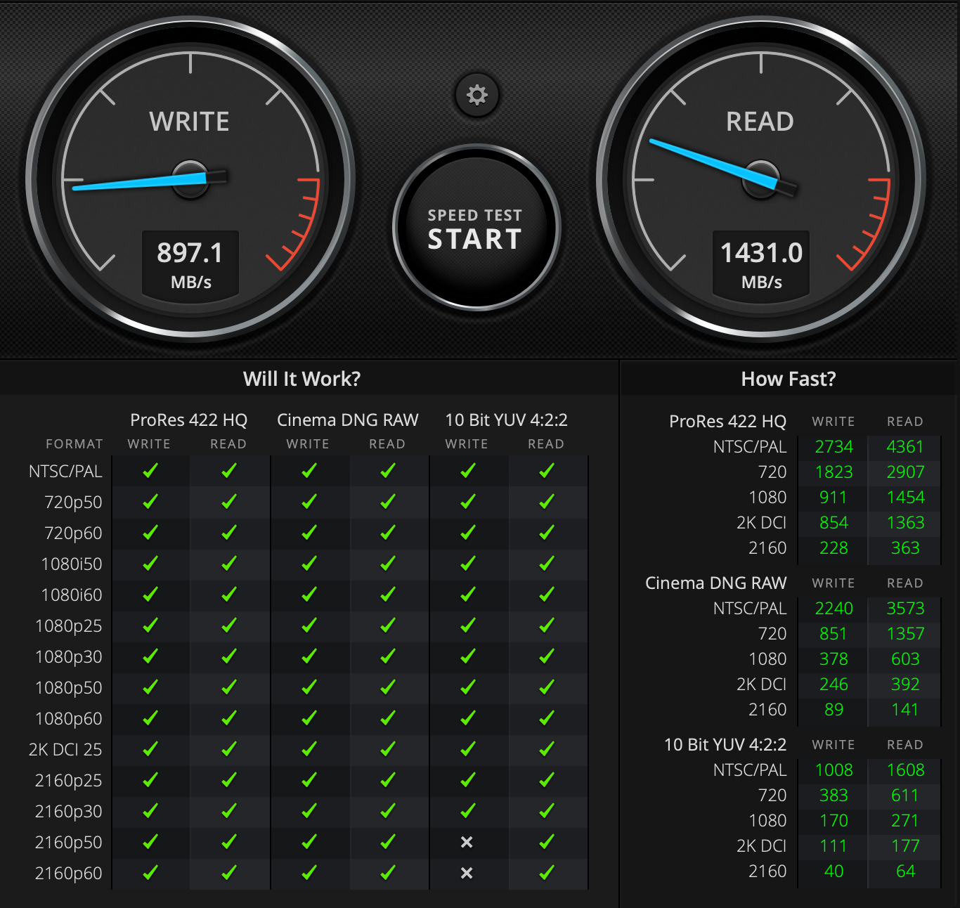

- Yeah 100% it's the external enclosure I am testing as the Fusion is now giving me 900 write and 1400 read.

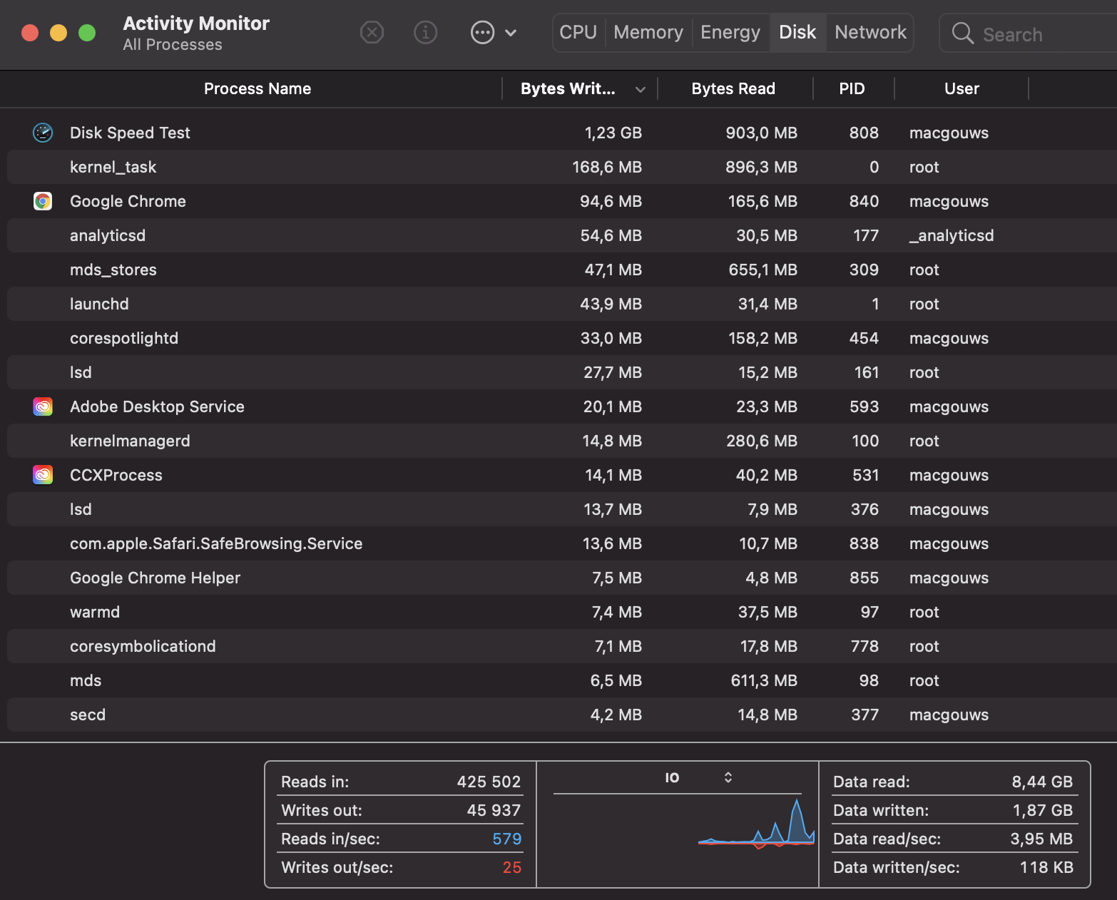

In Activity Monitor app, in your utility folder, there is a tab to see current disk usage. Maybe screenshot it and post it here?

So this is my activity after having the Mac on after 5 minutes. I did a test to see and it is still slow after just restarting with no apps open.

And here is the Fusion Drive that I wiped and made an additional drive.
This is the same drive that crawled when I had it as the boot drive and took 8 minutes to load the OS
