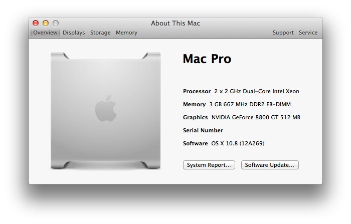

Following dead.xx's direction. It works however I can't select the volume as a startup disk even resetting the PRAM. This MacPro 1,1 used to have an ATI X1900 XT card in it until Apple replaced it with a nVidia 8800 GT through the repair extension program. :p
Thanks, dead.xx.

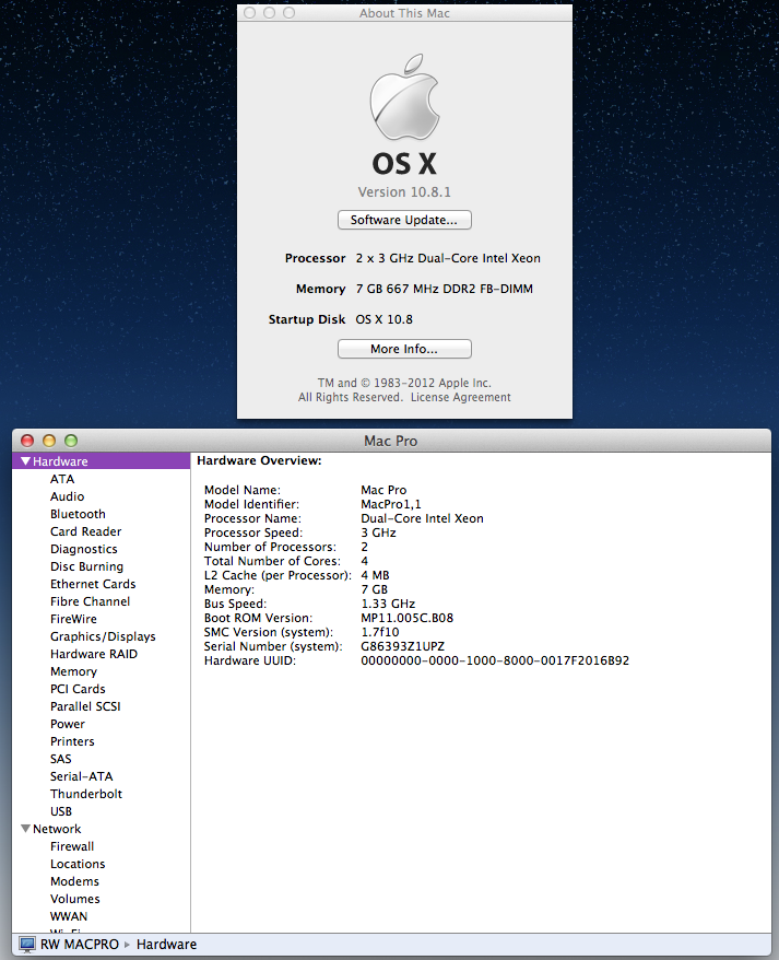

FYI
I installed the 10.8.1 update and had no issues. I figured it there would not be since it was such a small update. But I still cannot use dictation, Facetime and Ichat. I chat works with Google account I just cannot send text messages to other IOS devices.
