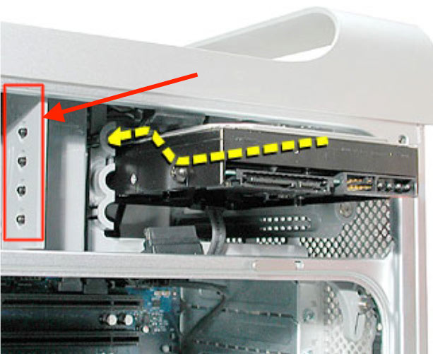

so i've installed a new HD on a Mac G5, and it's a 1TB HD. Luckily my G5 had all the cables i needed for it to run it. Now i have a problem. The original hard drive that's still in there fits in perfectly into the slots. the 2nd new hard drive is right under it, though its a little slimmer and it just lays on the metal. So it doesn't fit into the slots, and the hard drive is facing up. Should i be concerned about this? is this a big issue?

if you read on that PDF on the last page, my new HD is on the B section and it just lays on the floor. i don't know if that might cause some bad things to go wrong with the Hard Drive in the future. im not a hardware person so that's why i ask. thanks in advance 🙂
Is the new drive the same size as the other? The new drive should slide into slots exactly as the drive in slot A does.
I can't remember exactly where they are located but there is a set of button-head screws nearby the drive slots that are in a row. They are there for exactly the reason you need. Take a look the drive in slot A and notice how the button head screws are on the sides of the hard drive. Use the four spare screws for the new drive in exactly the same manner.
I would not let it sit on the floor of the drive bay. If you absolutely have to do that, I suggest using at least a small piece of double backed foam tape to keep it from moving around or vibrating.

If your G5 has never had a second drive before, the 4 screws necessary to screw into the side of the 2nd drive to get it to mount correctly will be provided from the factory in the space I indicated in red in the pic below (which I got from the guide you linked to, so disregard the yellow arrow as that is part of the original pic).
If a second drive was removed, the screws need to be transferred to the new one.
And in answer to your question, no- laying loose on the bottom is not the right way!😉
