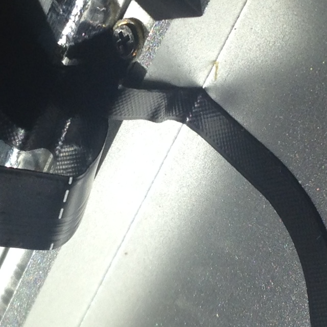

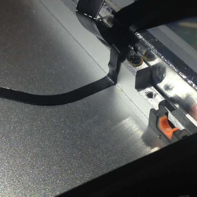

It looked like the cord by the hard drive was a little bent, I straightened it out best I could and i'm now installing os x on to the new drive. I'm thinking the cord actually might have been the issue instead of Hard Drive failure, even for my old drive. Going to put my old drive in to my friends Macbook to confirm
I tried the new hard drive & it worked as far as installing the new os x, restarted it and got the question mark sign. Moved my original hard drive into my friends macbook and it worked fine, wasn't corrupt as the apple guy told me. I was wondering, do you think this might be the problem? In my friends computer his cord connecting to the hard drive didn't look bent/longer like this. It's the original one I got with the mbp

Yep, looks like a bad hard drive cable. I think your hard drives are fine.
Ok cool! I was glad to see all my files were still there. I'll take it in to them on Monday to see the rates for replacing
