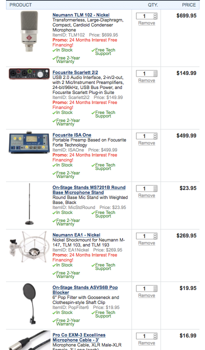

Dude thats a massive budget to record some home vocals, you'll get some killer recordings with that price.
And i realised i missed on on Monitors.
A Pair of Yamaha HS5's will do you nicely, and a set of Audio Technica M50s will do for some headphones, that will have around 500 overall, still leaving you around 400 short of your budget 🙂
Thats a pretty damn good setup, needs some acoustics, and IMO, you don't need anything more than GarageBand, but you could pick up Logic X if you felt inclined.
What you have there, is Studio Quality Mic and Mic Pre, and then a small interface to get it into the computer.
Acoustics wise, i would probably just hang some carpet up on the wall, or if the room your recording in sounds ok, just rock with that. I personally, HATE recording in iso booths, or rooms that are really really dead sounding.

I'd suggest an audio interface with two XLR input channels.
The MacPro still has firewire input, is that correct?
In that case, I'd recommend a firewire based interface, primarily because just about all firewire interfaces are "CORE Audio compliant" -- that is to say, they utilize the CORE drivers that are built right into the Mac OS, instead of relying on "3rd party driver software".
Something like this would serve you well (no financial connection to auction):
http://www.ebay.com/itm/Echo-Audiof...uter_Recording_Interfaces&hash=item462298ca21
I use an Echo Audiofire8 and it was arguably the easiest peripheral I've ever connected to the Mac -- just plug it in, and "there it is" -- ready to be used by all the audio apps (again, no financial interest):
http://www.ebay.com/itm/ECHO-AudioF...uter_Recording_Interfaces&hash=item43cb802898
You can use either the built-in mic preamps of the interface, OR, you could use a standalone preamp such as the FNR RNP, very nice little "box" for the money.
I'd also suggest a TWO-mic setup, otherwise your recording will be "plain mono".
For vocals, you'll probably want a large-diameter condensor format.
Mics are a whole topic of discussion in themselves, but you'd probably do fine with a pair of Shure KSM-27 or KSM-32 mics.

Your thinking here is way over the top for a hoe studio recording some sunday school songs. Here is what really matters
1) The room itself. Do you have a large walk-in closet with clothing hanging on all for walls. That would be the ideal room. Lacking that look around in yur house for the best room you have. Typically this is going to be a bedroom but maybe not. TEST the room by recording a stand-in even some one who can't sing well. LISTEN to the recording. Dosome minor fixes if you must, hang a thick rug on a wall if you must but rig it so it is easy to take down.
2) In a home studio with poor sound isolation and not perfect rooms you want the microphone to be CLOSE. This way it picks up more of the vocalist and less of everything else.
+++++ stop here until you have done the above +++
3) Do not go nuts on equipment. You need deselect "large condenser" microphone but don't spend $500. Many of the Chinese made ones are just fine. I bought a used AGK for $80. You can buy a new AudioTecnica AT2020 for cheap. Something along those lines. The 2020 is good. If you have the bucks the Rode NT1A. It's hard to say until you've heard the vocalist and tried a few microphones. You can't so just get a decent general purpose on like the 2020.
4) the idea to use two mice is not helpful. Get one that is very close and use a pop shield. You can listen after each take and make fine adjustments remember you are NOT recording a one-time event. You don't need backup systems
5) The preamps build into even $150 USB audio interfaces are good enough. Yuowill not hear the difference if you upgrade to outbound preamps. If the microphone is reasonably sensitive and if it is close and if the vocalist is reasonably loud this will be a very easy job for the built-in preamp. Try the built-in preamp first and ONLY if you KNOW you have a problem then spend $1k on a preamp. What maters most is the gear that is closest to the sound. First is the singer, then the room then the microphone then the amps and interface
6) that bit about fire wire vs. USB is "bunk" and matters not in your case. OK if you have 16 channels of 96K/24-bit audio it matters but your one or two tracks does not clone CLOSE to stressing USB. Two good audio interfaces to look at are
Presonus "Audiobox" and
Focusright "Scarlett 2i2"
This audio interface you listed are just "nuts" for this application and for a one of two channel recording are a total waste of money.
Both are $150 and about as good as you could want.
Do not blindly copy what people do in studios. This is a home recording made in a not-perfect space with dogs barking and trucks outdoors and who know what else.
Have the person face a non-reflective surface. An open closet with hanging cloths works. Get the mic up close and use a pop filter.
VERY IMPORTANT: record this using 24-bit samples and do NOT let the level go even close to clipping.
You should be able to set up everything you need for $400 total, mic, interface, cable, stand and filter. (Assumes you have computer, headphones stereo speakers and audio amplifier.)

Well, thanks to everyone for their responses. It generated a few more questions.
1) Fishrrman suggested TWO microphones. Since my mic is likely to be the most expensive component of my setup, I am disinclined to buy a second mic. Does anyone else have an opinion on this?
2) The whole pre-amp thing is a bit confusing. My understanding is that most of the USB interfaces have a pre-amp, but that buying a separate dedicated pre-amp will improve the sound input. Is this correct? If so, what is the difference likely to be in sound quality between, say, the Focusrite ISA One preamp with Scarlet 2i2 vs. the Apogee duet? Does the duet have a good quality pre-amp included? Or are you just paying a ton for good marketing and versatility?
Also, I came across the SPL Crimson. It's a bit more than either of the aforementioned products, but I am wondering if it is in any way superior.
3) Fishrrman also mentioned that it is better to use firewire (which my computer does have), or is USB just as good at this point? I expect that this will be my last firewire computer, although I expect it to last a while. I suppose the Focusrite Saffire Pro 24 DSP, or the Echo Audiofire4 would be options?
I'm still vacillating on the microphone choice, but I've decided to go with the Yamaha HS5 speakers and the Audiotechnica M50 headset.
The nueman mic and preamp are bit over the top for a home recording. I'd bit the price of the gear that hardly anyone would hear the difference if you bought a an AT2035 and plugged it straight into the Focusright audio interface.

Hi folks, Thanks for all of the above advice. I read and re-read most of the posts many times, and here's what I ended up with.
Mic - Rode NT 2000 ($600 new)
Preamp - Apogee Duet 2 USB ($405 used) - judging from my initial impression, this is the component that is most likely to be replaced before too long, but we'll see
Headset - AudioTechnica M50x ($110 "used", but oddly still in the original packaging, etc.)
Monitor speakers - Yamaha HS5 pair ($250 new)
Logic Pro X ($199)
I was able to stay well below my initial equipment budget, but I still have to treat the room. I'm going to follow several people's advice and do this piecemeal until it sounds all right.
