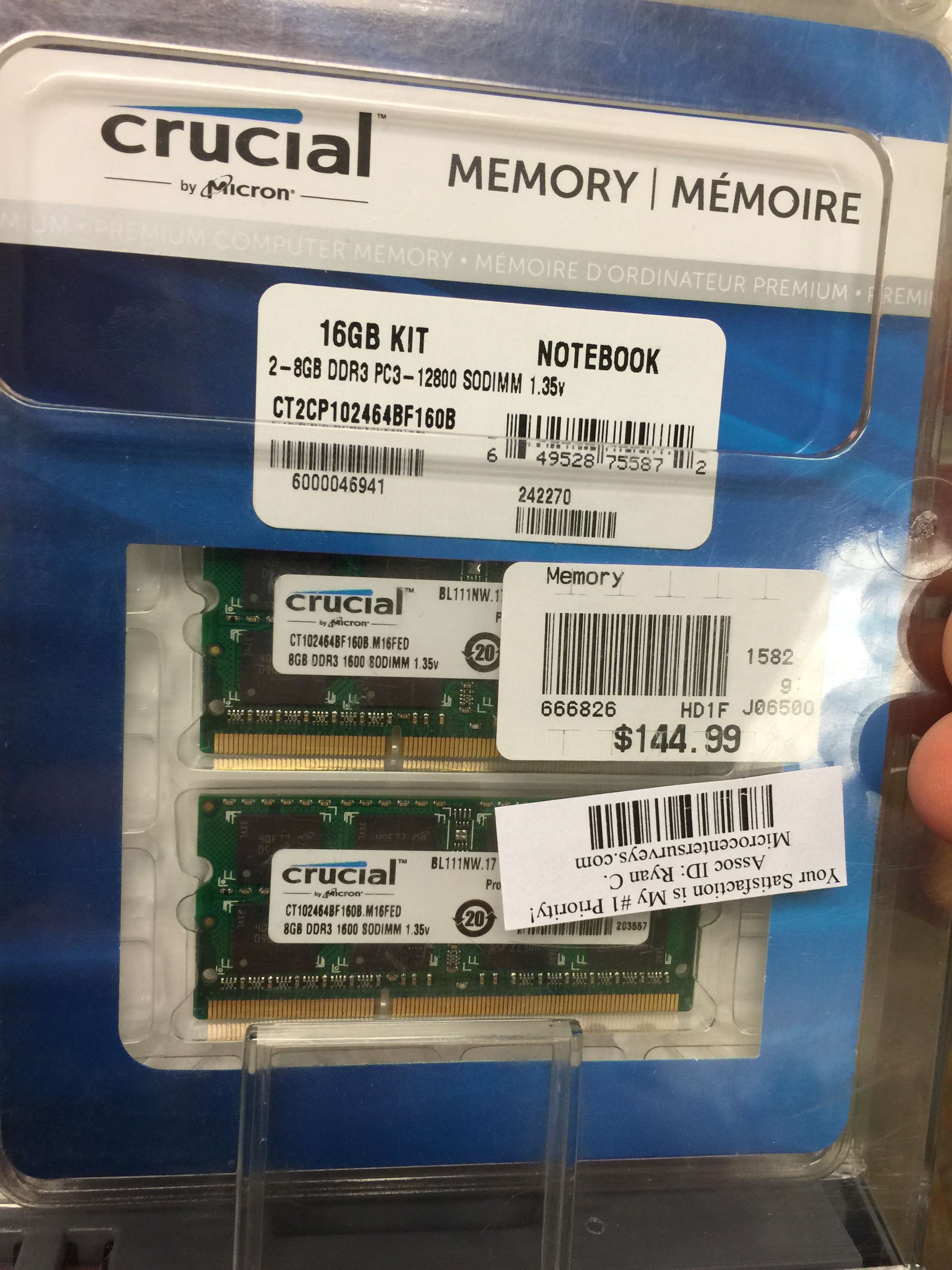

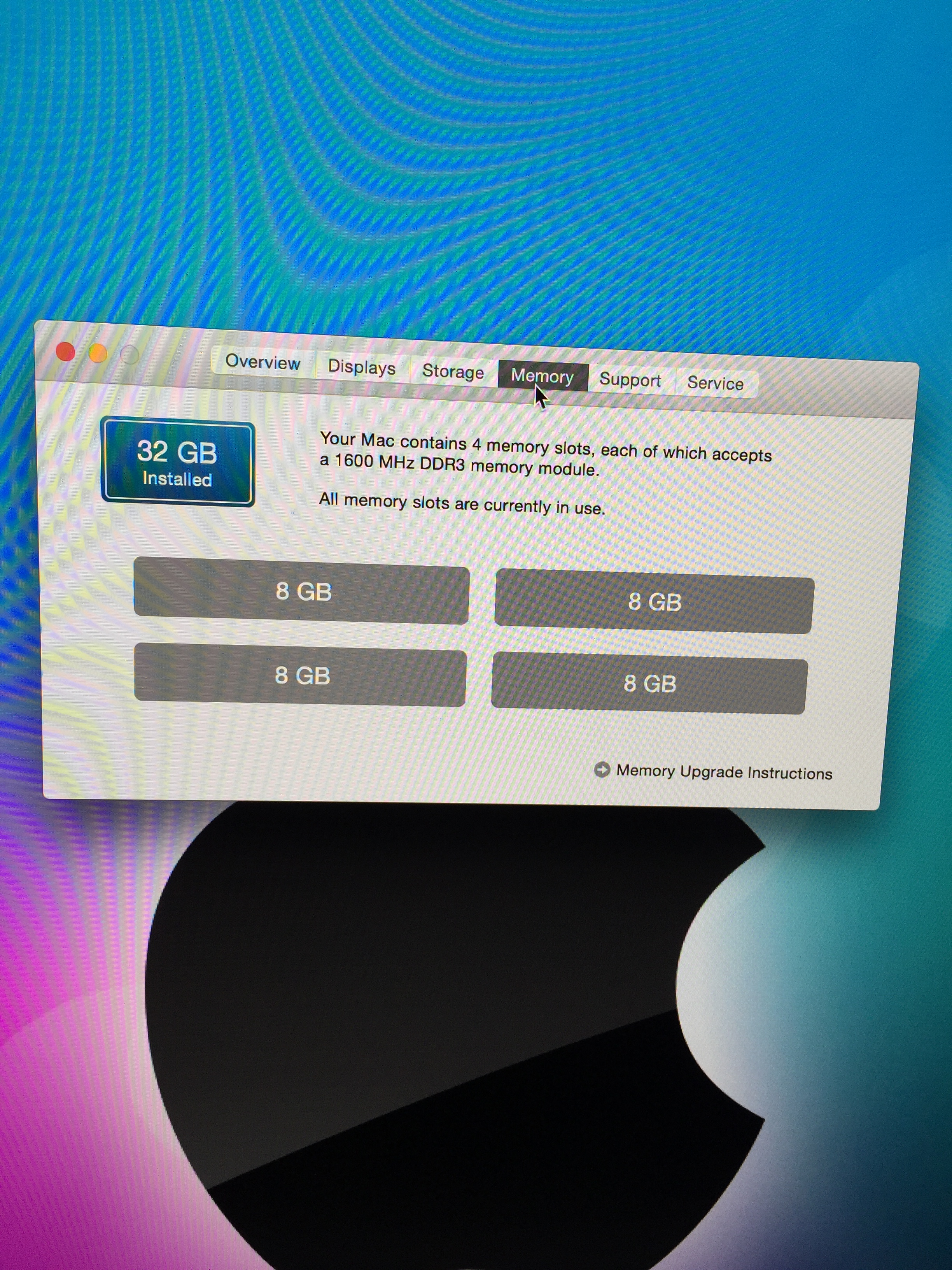

I just got a new iMac 5k two days ago. Yesterday I walked into MicroCenter and bought 32 GB of memory for under $200. Price tag shows $144.99, but MicroCenter had a sale for $99.
The whole process to upgrade took literally 2 minutes.

I looked up the one you purchased at it says its "CL9". I see the one for $129 which is "CL11". But the post from "loekf", says it should be CL11, but how's it working for you?

I have two of these in my 5k iMac.
Looks like you have this one:
http://eu.crucial.com/eur/en/ct2c8g3s1339mceu#reviewDetails
which is CL9.
I think Apple's official specs are CL11. CL9 *could* give you a 1-2% performance gain for some tasks, but no guarantees. The higher the clock speeds for memory these days, the less relevant CAS latency is.
You also have to careful if you add faster (CL10, CL9) RAM to the two already placed modules by Apple, which are CL11. Your iMac might decide to downgrade your RAM (e.g. to 1333 MHz).
I bought the one from Amazon that is the CL11 version after using the Crucial website to determine which memory was compatible. So far it has been working great, ran a few memory tests and it passed all. No crashes or waking up from sleep issues I've read about as well. I almost bought the CL9 from Microcenter before, because I noticed it was priced lower, but now glad I did not.
