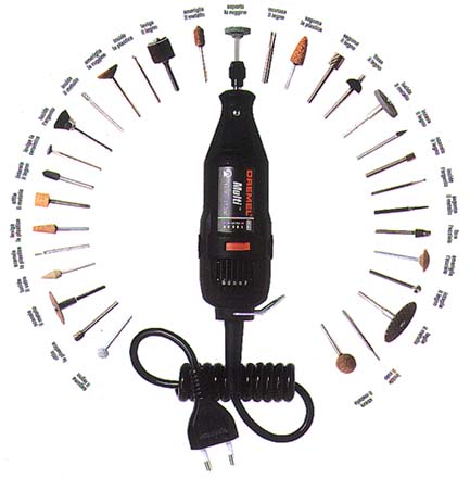

get one of those and get rid of the sharp edges , easy job on alloy as its soft, should take less then 5 minutes to do the job
http://www.corel-srl.it/images/dremel_foto.jpg
Only problem with a Dremel is that even with a vacuum nozzle sucking away any metallic dust, you could still get some in the drive and or SD slot., I'd suggest very gently filing it down with a pull away motion and a vacuum cleaner (this will drastically reduce the amount of dust made), or something else - i.e. rough grit sandpaper then graduate to finer grit sandpaper.
