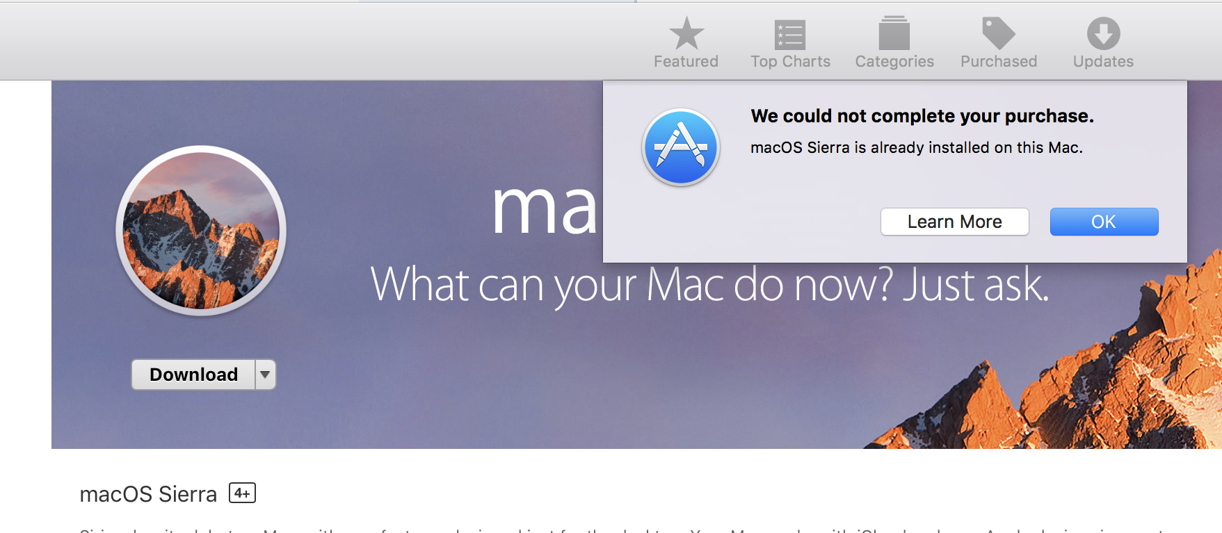

Seems i cannot download it anymore .. at least not from the 2017 imac . I did try from an older mac , same issue

Just keep pressing download. It will say that every time. It's just telling you you already have the current version installed.
