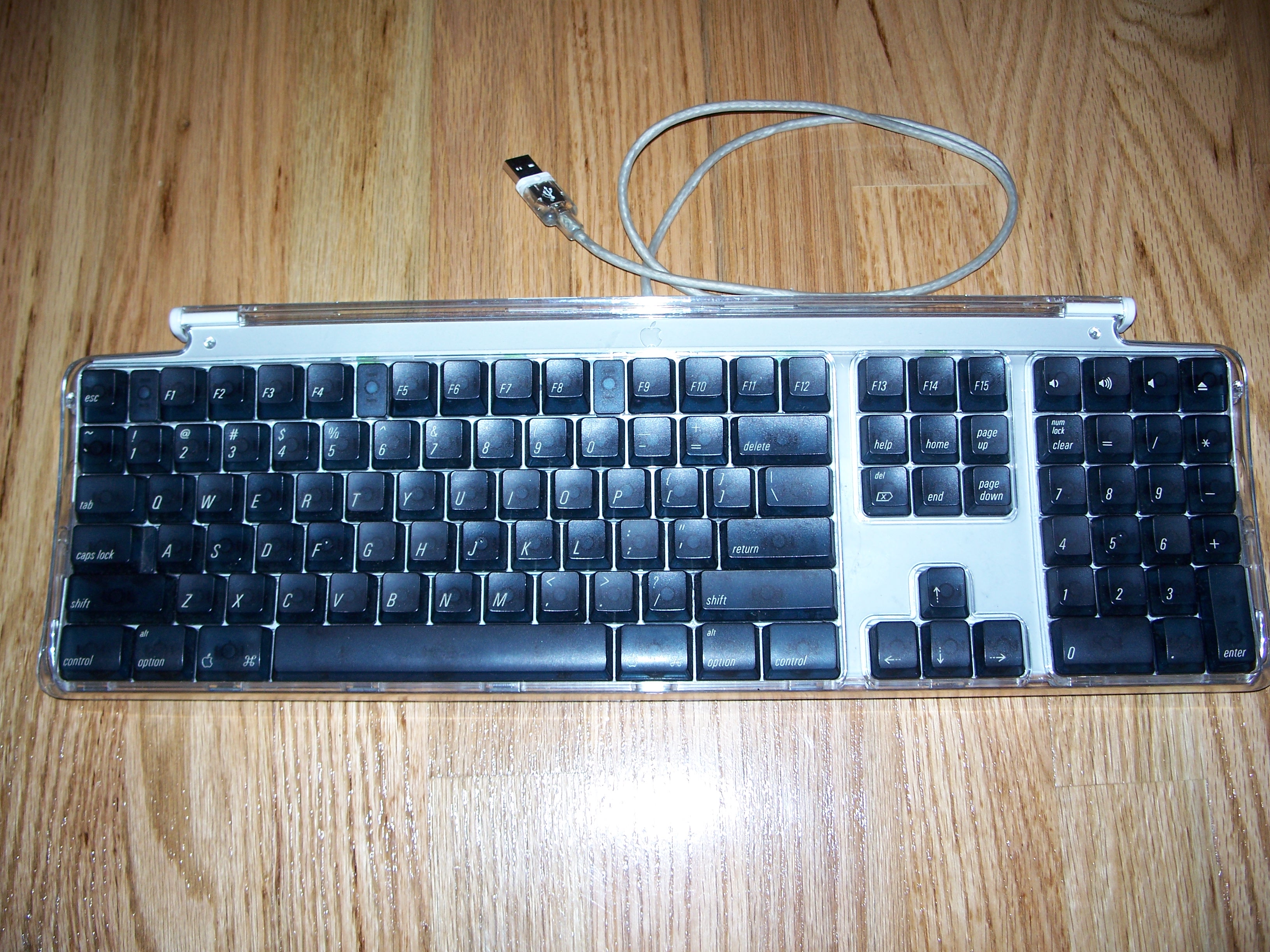

Hey, I just took my black M7803 keyboard out and booted into OS 9.2.2 (MDD 2002) to try a few minutes ago. The volume and eject keys worked fine there. I have no idea what might cause the problem.

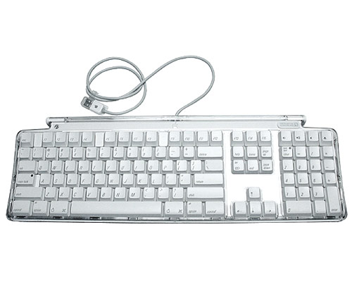

Your iMac should have come with the white M7803 like this: http://www.vectronicsappleworld.com/archives/vintage/0035.php

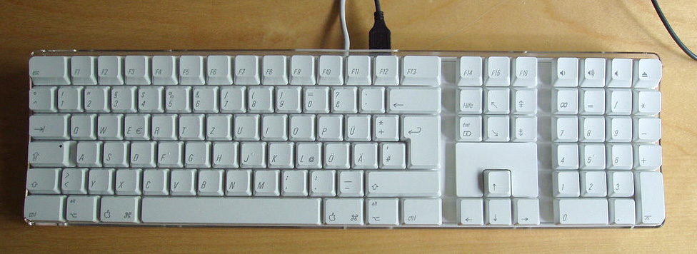

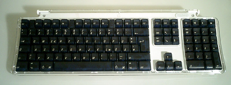

We can't have you posting German keyboards as examples 🙂

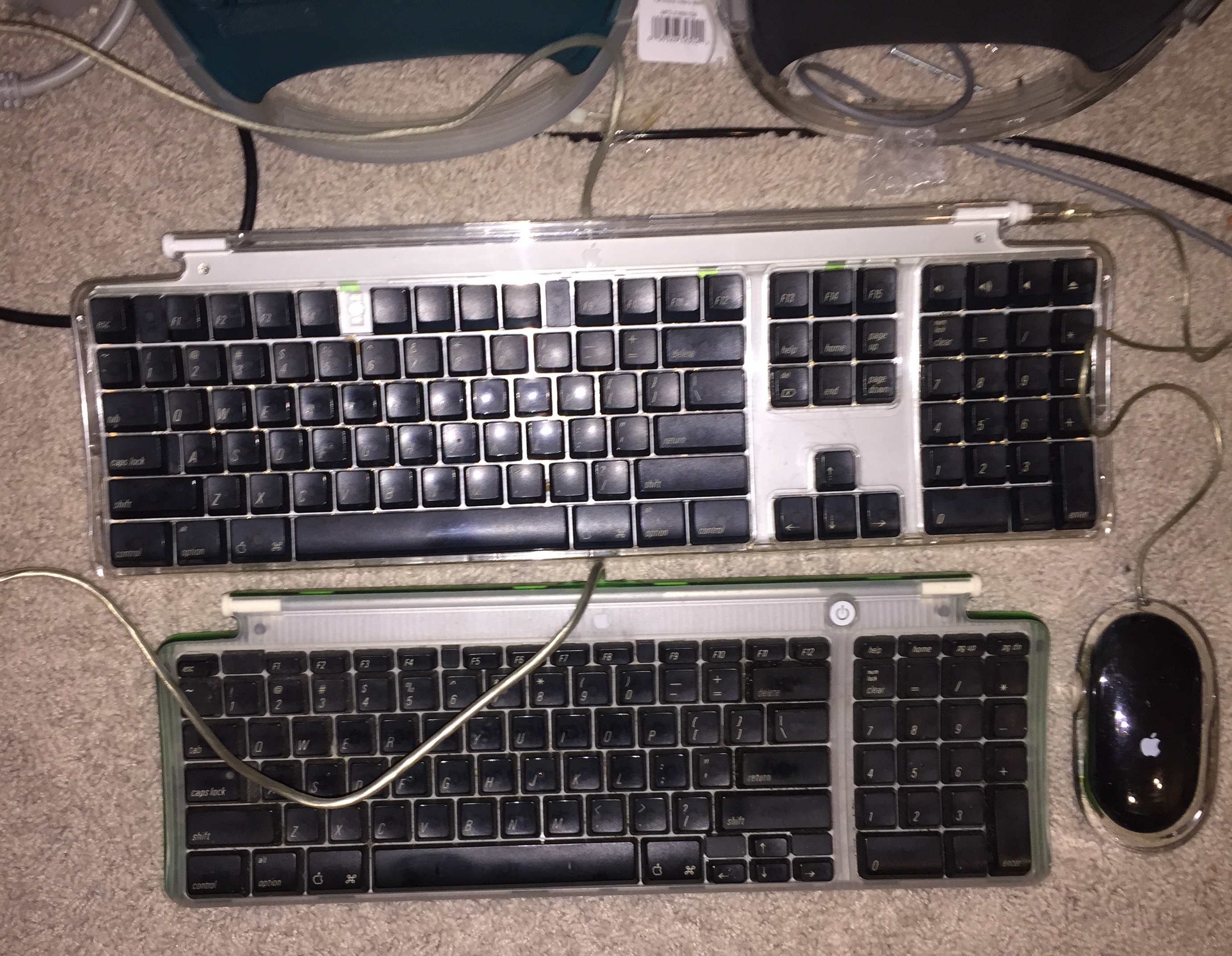

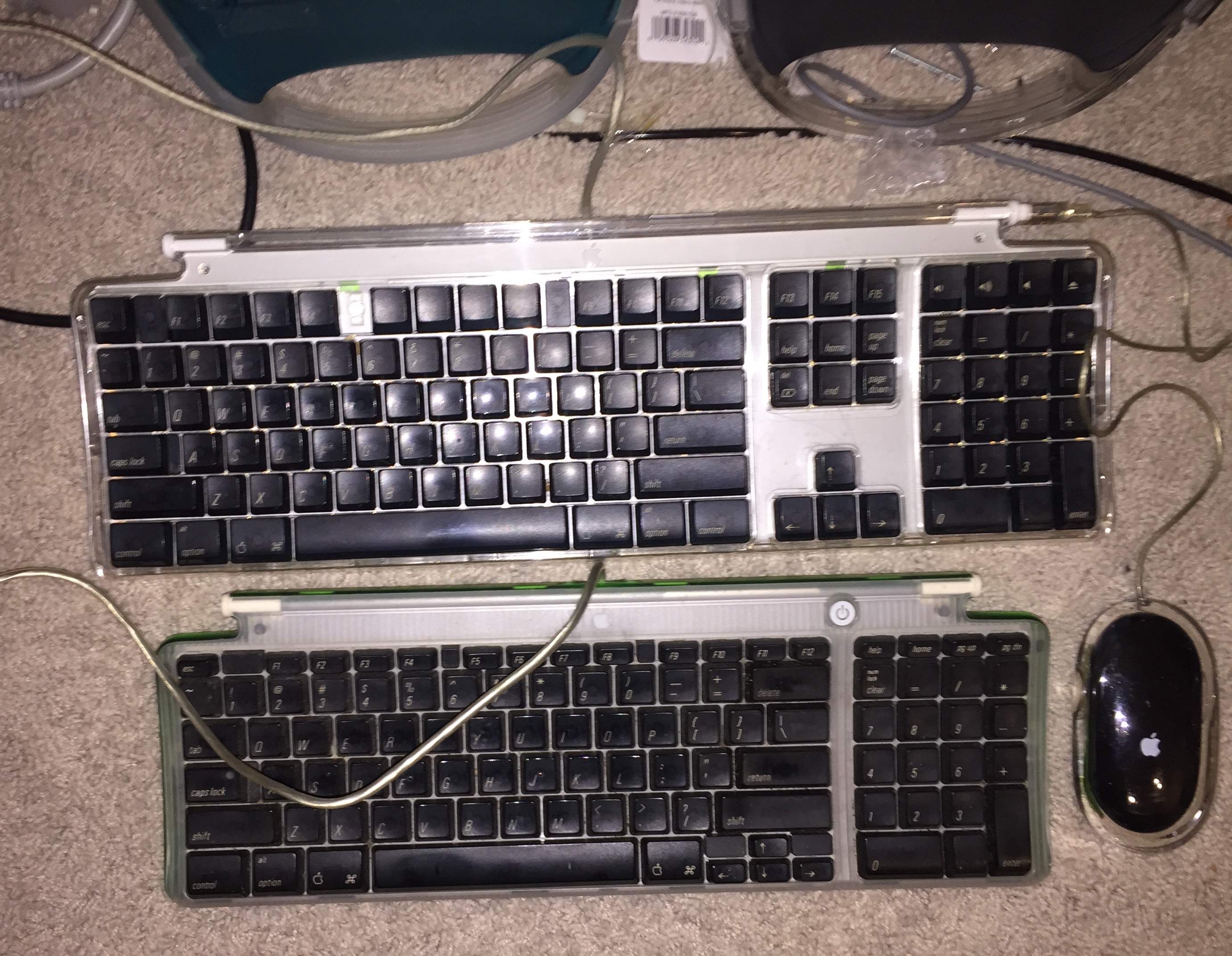

Here's the US layout of both the M7803 and the M2452. The M2452 is a recently acquired example in lime green.
I bought three of the M2452s from a forum member here last week, but honestly I don't know why I bought them(other than the one specific lime green one I wanted). I've picked up so many of those things from surplus that I find them stashed everywhere. I was cleaning the "winter stuff" out of the trunk of my car the other day and found two of them lurking in the back. With the exception of the lime green one, all the others I have are Bondi Blue.
Ugh my apologies. Or should I say entschuldigung... or is it entschuldige?
I forget which one which for is for saying "excuse me" aka "sorry" (versus excuse me I need to pass by you or excuse me I need your attention). Or as we would say in Hebrew, לך תזדיין - transliterated to lekh ti'zedayen. Wait, you might want to double check that translation before you say it to an old woman or some macho guy who speak Hebrew 😉 😛 😀. You know I'm just messing with you! <333
Who posts pictures of their german keyboards on the internet anyways. Thanks Wikipedia.
Hoarding gene. I'm not sure why else you would collect those terrible keyboards. By far one of the worst products ever produced. I used those for much of my elementary school education and I could never get used to them.
