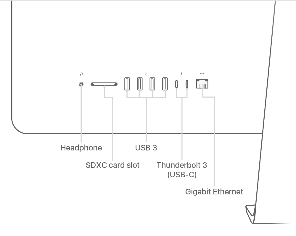

I just received my 2019 27" iMac and am a bit confused about how to get it set up. I have a BenQ Sw 2700 monitor with display port and HDMI outputs that I would like to use as an external monitor as well as a G-Raid thunderbolt drive that I want to attach. They are currently attached to my Mac Mini by using a display port to mini display port cable running into drive and a thunderbolt cable running from the drive to the computer. I'm wondering what the best way to hook tase both up to the new iMac? What do I need in the way of adapters? I also have a usb hub with a regular usb connector I would like to attach. Any advice on how to do this as cleanly as possible would be appreciated.

so, the usb hub plugs in as normal.
You''l want a USB C to DisplayPort Cable (or adaptor) for the monitor.
Thanks for that. That would certainly allow me to attach the monitor, but I'm wondering could I continue to have the monitor run into the raid drive with the cable I'm currently using and get a thunderbolt to usb C adapter to run into the computer, daisy chaining it as I am now?
Do not daisy chain the display.
Get a USBc (Mac end) to displayport or minidisplayport (display end, which size you buy depends on the display input).
Is the thunderbolt drive you have tbolt2 or tbolt3?
I apologize for not being as up on tbolt as I should be, but seems to me that if the drive is tbolt2 (or tbolt1), you'll need a tbolt3-to-tbolt2 adapater to connect it. (others please correct me if I'm wrong)
Existing USB hub can plug into the USBa port.
But be aware that if the hub you have IS NOT USB3, using it will slow everything down!

The raid drive is the first generation of Thunderbolt, I believe. I’ve looked up adapters to be able to change the plug to thunderbolt 3 and they are available, but rather expensive, at least from Apple.
Why would you recommend not daisy chaining the monitor? If I don’t this would tie up both thunderbolt ports on the Mac.
I’m wondering if when all is said and done, would I be better off just buying a dock, such as the Caldigit and be done with it?
That's what you'll need if you want to keep using the G-RAID (assuming it doesn't have USB 3 as well).
All you should need is to add the TB3-to-1 adapter to your existing setup. There's no reason not to keep your display daisy-chained unless it gives you problems, and a 1440p display plus a Thunderbolt 1 hard drive shouldn't be a bandwidth issue. It's exactly what you're already doing with the Mac Mini anyhow.
You need the TB3-to-1 adapter anyway so suck it and see. If you do get problems then, yes, run a USB-C to DisplayPort adapter straight to your iMac - but if it ain't broke, don't fix it.
Your old USB hub can go into any of the USB-A connectors or to the second TB3 port via a USB-A-to-C adapter. There's no speed/performance advantage either way - it just comes down to whether you prefer to use up a USB-A port or a TB3 port.

I just wanted to follow up. I received the thunderbolt 3 to thunderbolt cable this morning and plugged my G-Raid drive into my new iMac and the drive showed up and the daisy chained monitor works as well.
