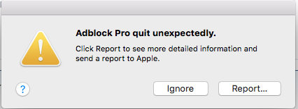

Hello,
I have clean installed the MacOS High Sierra on my MBP 13 2010. I have reinstalled 2-3 times using new official HS setup.
Everything is working great except i cannot run any apps installed from Mac App store. 3rd party apps are running fine with dmg setups.
Adblock, Speedtest, Blackmagic disk etc. all are crashing on startup of apps. All apps versions are compatible with High sierra though.
I have tried resetting the app store caches also through terminal.
Pls help.

I found a solution (thanks to @DocteurQui ). We only need to delete file “valid.sqlite3” on /Library/Keychains/clrs.
And now, if we open an app, it works. In this case I don’t know if this is a permanent or temporary solution but meanwhile we can use apps from AppStore.
The problematic file come back after a while, I guess a script that delete it automatically would work but I have no idea as how to do it !

Might have stumbled on a longer-term workaround.
Replaced "valid.sqlite3" with file from an iMac running High Sierra that has no App Store issues. Tested for a while and App Store apps have been working fine with no need to continually delete the generated file. Since High Sierra is new to this iMac I have no backup of "valid.sqlite3" which is why I used one from another iMac.
