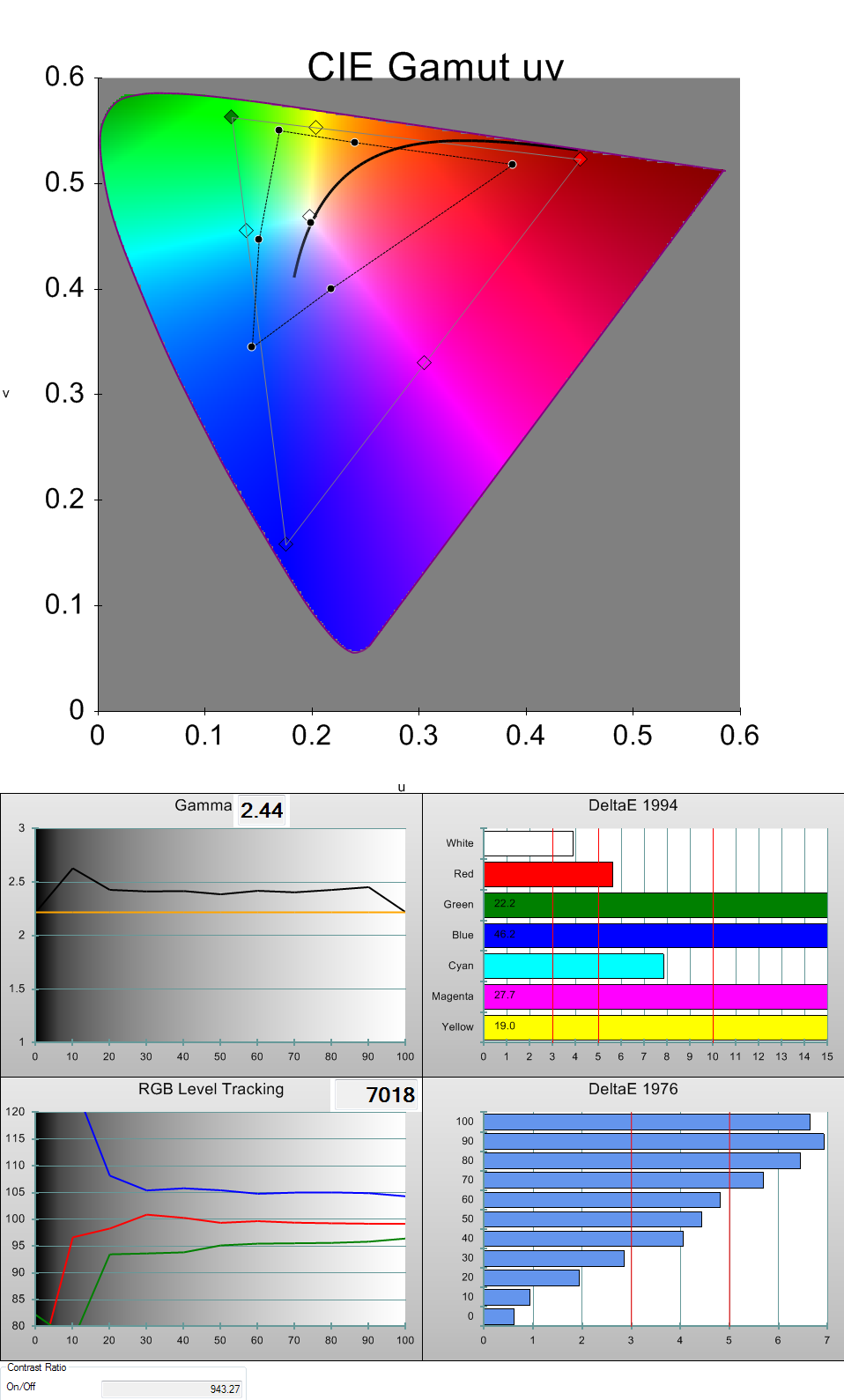

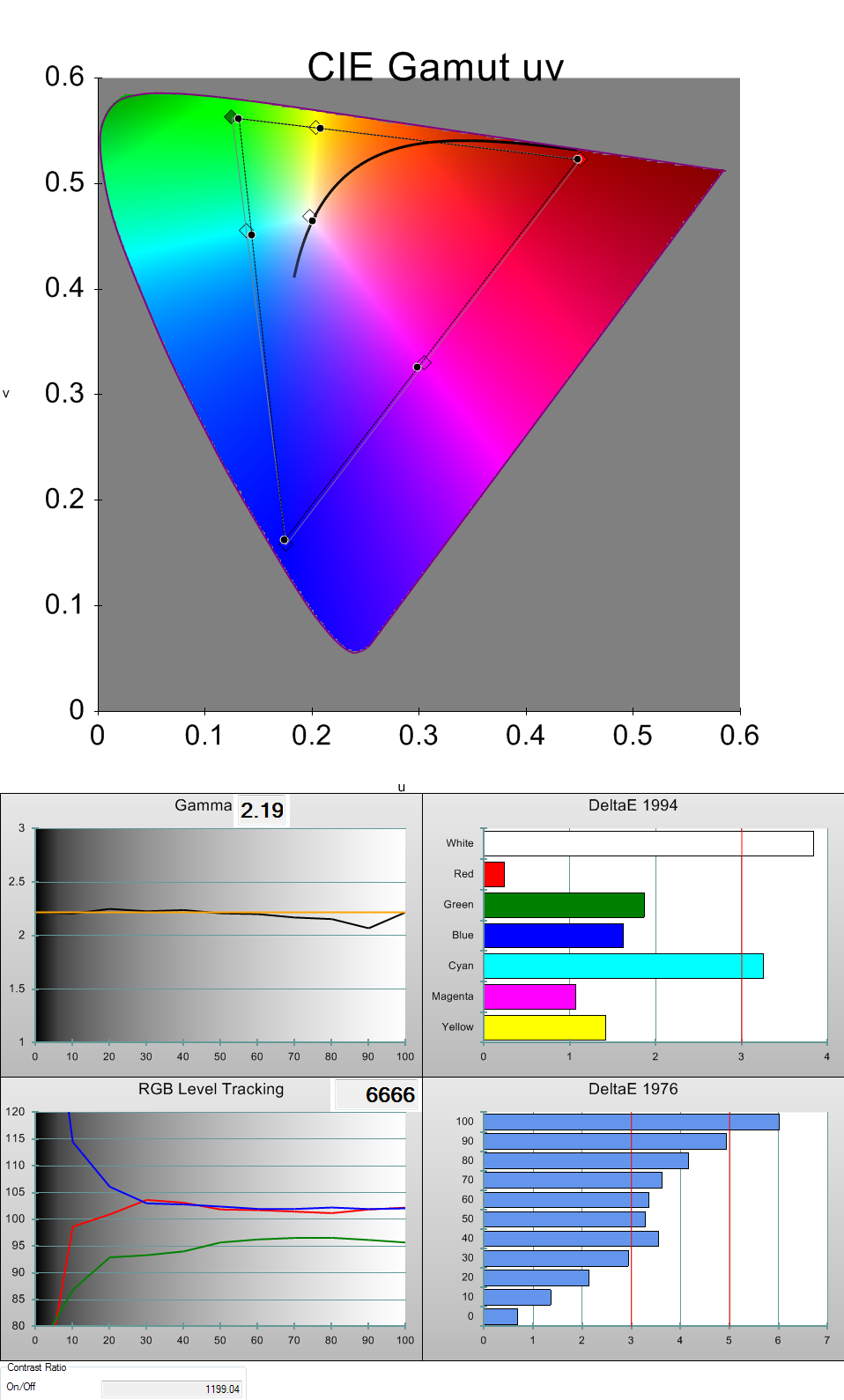

iPad 2 / iPad 3
Source
If you compare the CIE gamut charts, you can see that the iPad 2 "yellow", which will have a definite impact on the sepia toned background, is actually in the orange region of the chart.
The iPad 3 yellow is very close to where it should be, but still slightly skewed towards red. If you've been using an iPad 1/2 for the last year or two, while that yellow is far more accurate, it's going to look "green" for the first week or two until you adjust to it, because you're used to how the old iPad screen looked.

White balance is something that appears to vary between individual iPads (the colour gamut should remain fairly consistent, differences there will largely be between the tools used to measure it) but the new iPad should be as good or better than the old one, depending on whether you got a "good" one or not. Mine measures close to the ideal 6500K, whereas some people have reported around 7000K, which is closer to the iPad 2s. (higher numbers have more of a blue tint) In that comparison, you can see that both iPads are actually a little green deficient on the RGB Level tracking chart (ideally all three at 100) but the new iPad doesn't have the blue push of the old one.

Note: the DeltaE graphs show colour error, with lower numbers being more accurate. A DeltaE of three or less is considered to be very accurate. It's a very impressive display considering the cost of the device. It probably bests most LED backlit LCD TVs. I know that my Sony LCD which cost considerably more, doesn't have colour as accurate as that.
