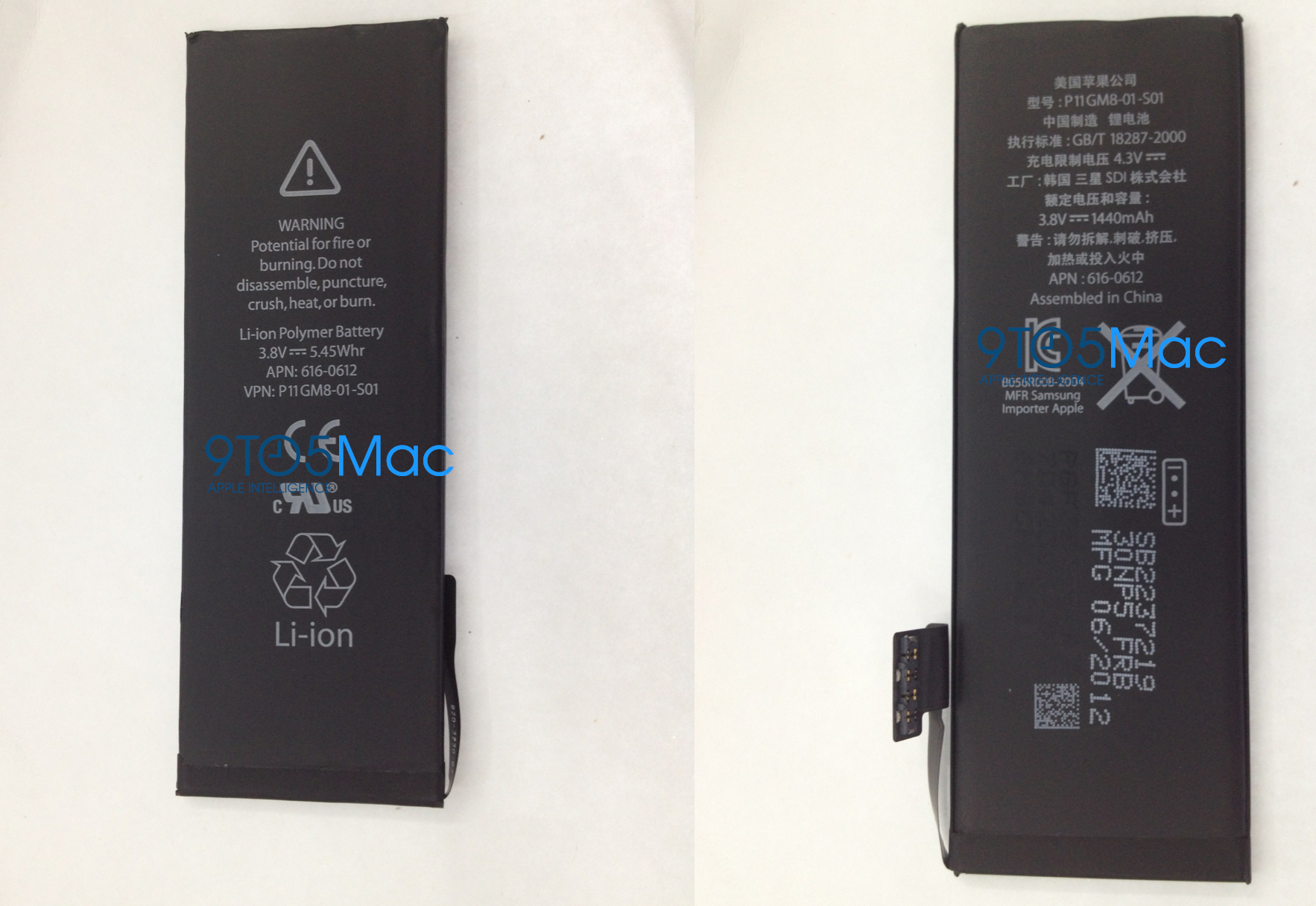

The new iPhone is very likely to feature a new battery chemistry that is more efficient and lasts more charge cycles without degradation, something Apple has made a big deal about in their laptops. There are several news stories and rumors to support this. The first is the battery leak that happened August 9th

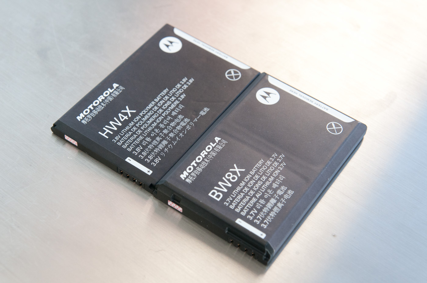

If you notice in the photo on that news story, the nominal voltage on the battery is 3.8V. Normal Li-Ion batteries in mobile devices have 3.7V. Now, this likely isn't just a case of an overcharged battery, because the droid bionic had a similar battery and anandtech did a little digging on it.
Anandtech Bionic story
A source reached out to us and let us know that the Motorola Bionic's 3.8 V battery is in fact using a new alternative high voltage chemistry, and is not simply an overcharged Lithium Ion battery. This same battery will be used in the just-announced Motorola Atrix 2 as well. Note that the battery name includes an H (eg HW4X) to denote the use of these high voltage battery chemistries. This new chemistry also has similar cycle life as existing 3.7 V nominal batteries, and has been in the works for several years.

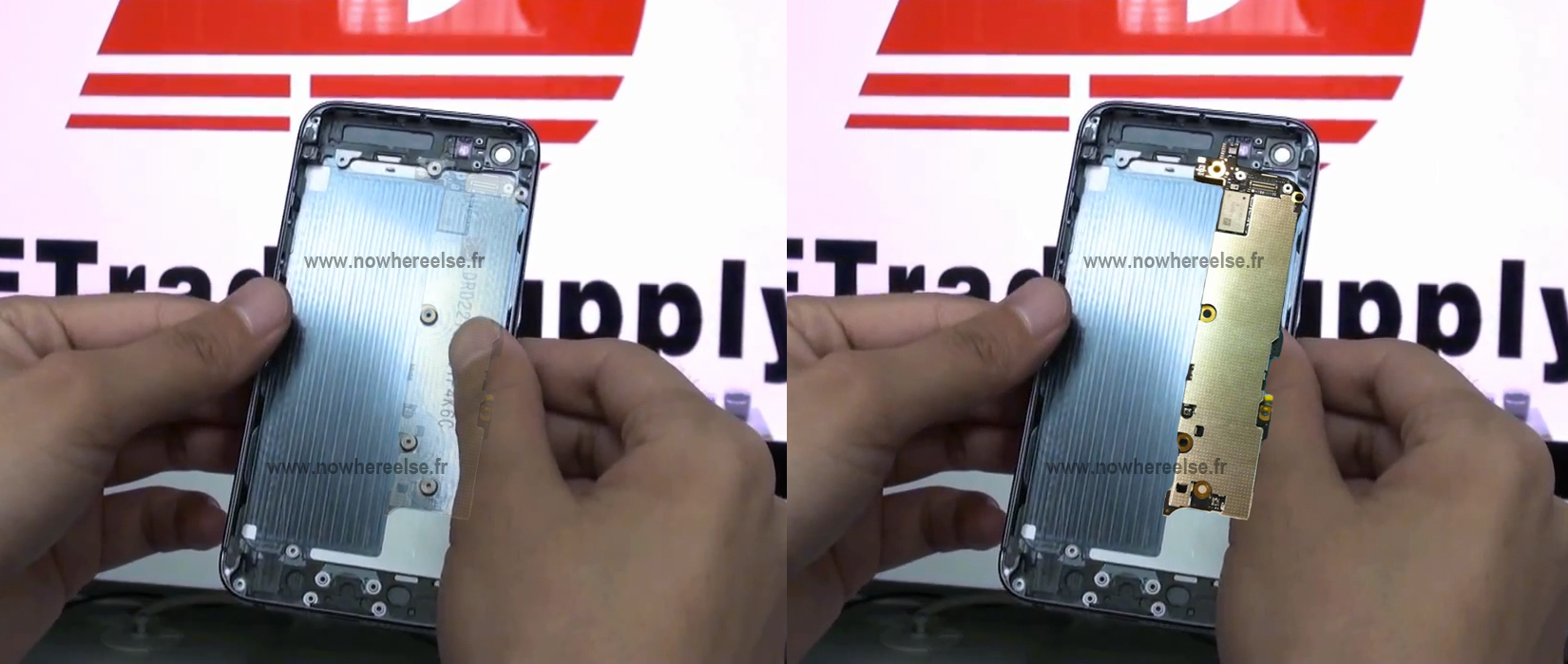

Look at the PCB and battery orientation:

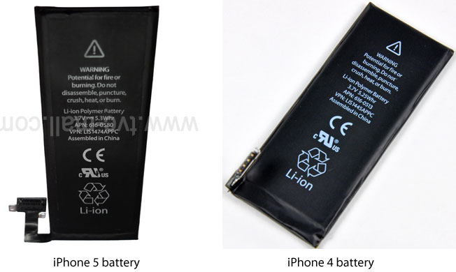

On August 22, macrumors featured another battery leak with a battery that featured a 3.7V battery as we would expect. The part number was also similar to the iPhone 4 battery. edit: arn pointed out this story is a year old (whoops), so it's a non-issue. That was the 4S battery, which was still being called iPhone 5 at the time. Most of the discussion below is relevant and it legitimizes the PCB and battery compatibility.

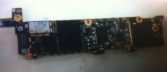

Leaked PCB and housing shots suggest that the PCB will be on the right of the new iphone, not the left as in legacy iPhone devices (4 and 4S included). The battery connector also seems compatible across generations. Looking at the leaked PCB shots isn't conclusive given its blurry nature. However, if you compare the iphone PCB shot with the iPhone 5 PCB shot, it seems the iPhone 5 might have a compatible connection due to their extreme similarity, and one must also ask why they would be that different across the batteries anyway.
Given the evidence, I think we'll likely see a new battery chemistry in the next iPhone. However, this needs to be taken with a grain of salt, since we don't know if the 3.8V chemistry is what LG is using. Even if we find out that the new LG battery is 3.8V, that doesn't mean it's the same 3.8V technology we're seeing in the new iPhone. Since Apple loves to talk about their batteries, if it is featured, I think there's a good possibility they may talk about it. If they do, that could confirm they're using LG's tech. Still, if they're using a 3.8V battery, one must ask why Apple made the change if it didn't have some benefits in store for the new iPhone ultimately. It does, without question, at least confirm a new battery chemistry. The nominal voltages of batteries are directly related to the chemistry utilized within, so you wouldn't get 3.7V and 3.8V both using the exact same chemistry.

iPhone 5 PCB shots

Higher capacity iPhone Battery (courtesy: 9to5Mac)
Recent leaks out of China have, howver, indicated that the next iPhone will likely move to a higher voltage chemistry, up from 3.7 V nominal to 3.8 V nominal. This follows the move that Motorola made over a year ago to the 3.8 V nominal chemistry where I saw it the first time. Since then Motorola has shipped almost all its phones with 3.8 V batteries, followed by Nokia and Samsung. Thus it seems highly likely that Apple will also move to this chemistry given maturity and the tangible benefits it provides to battery lifetime.
