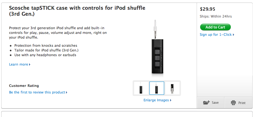

I got one of these for controlling the Shuffle with standard headphones and it works great. Good if you don't like another cable.
