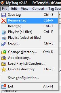

If you set it up as above, then load your albums, select all tracks, File>Remove tag it will strip out all unwanted tag info and just leave v3.2.

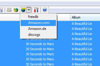

Or use the online database option to tag and add art for each album.
