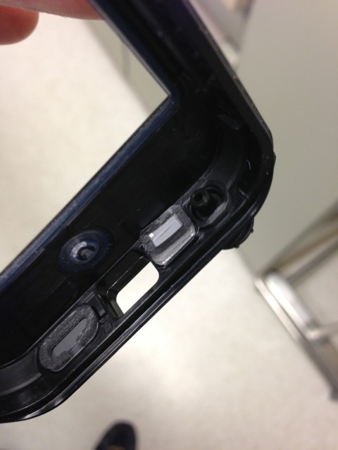

Ok I guess this Is my first post to this site and sorry if I'm going about this the wrong way. But I need to chime in
Yesterday I went to the White Water in Atlanta. While there of course I had to put the Nuud to work and I found that it held up quite well pics and video came out quite well. The occasional water in the lens area fogged up a few pics but that's it. Now I have had my Nuud for 3 days and no problem but this morning, when making phone calls I it's seems that I was muffled quite bad and the other callers couldn't hear me.
I took off the case to make sure it wasn't the phone and it wasn't. I put the case back on and there it was again. I took just the back off and still same problem.
Don't know what is causing this so I just threw my fre back on and it worked.
Also just to check I put the back of the fre on with the front of the Nuud and same issue. When looking deeper into I see that this could be a problem but not sure. At the inside bottom of the front on the Nuud there is a small square that I believe is for the mic and it seems that the foam around it has shifted and closed up the mic hole. ( now how could that be because I have not taken the phone out of the case and it worked fine for the past 2 days.)
Not sure what to do from here besides swap out the case. But if that little issue easily happened without me removing the case not sure if I want to keep it.
It is a very likable case though.
Someone else a couple of pages back in this thread reported the same issue with the foam around the microphone hole. From your pictures it looks like it's out of place a bit, but it certainly doesn't appear to be covering the hole... unless you had already moved it back.
The other thing you can try is to turn on hearing aid mode (Settings > General > Accessibility > Hearing Aids) Apparently this disables a noise cancellation feature and for me and a number of other people it made a big difference with people being able to hear me while I'm on a call.

Thanks I tried changing the hearing aid settings and still no luck. I compared it to my fre case and yes on the Nuud it's slightly off but I honestly don't want to touch it now. But I will anyway and report back later.
On another note. After using the Nuud lately the fre does sound muffled
