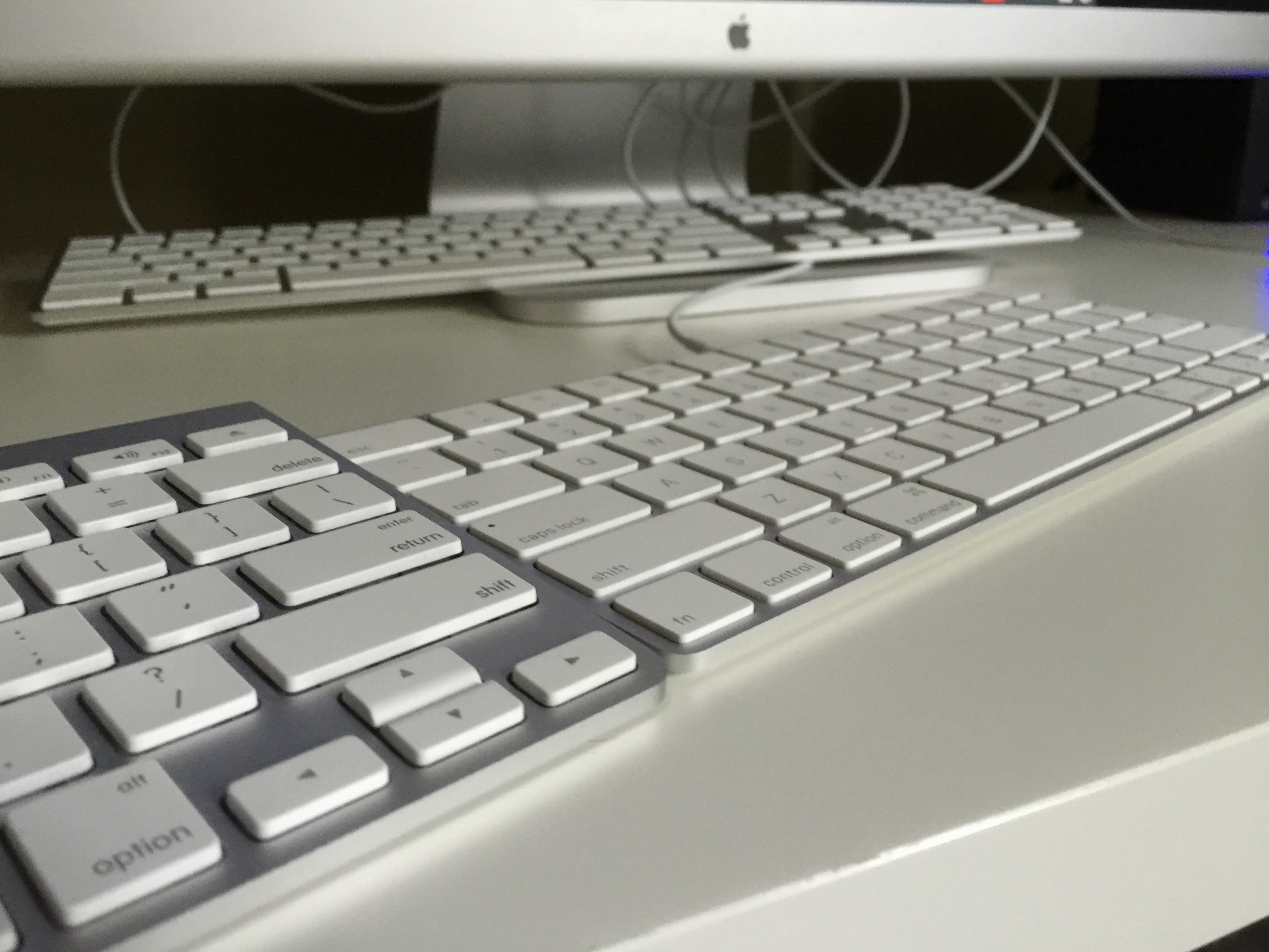

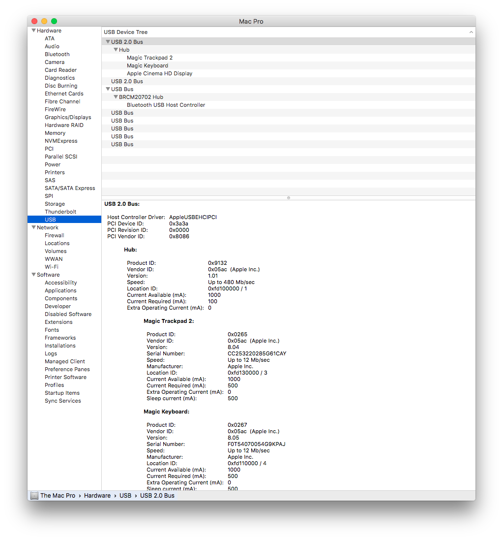

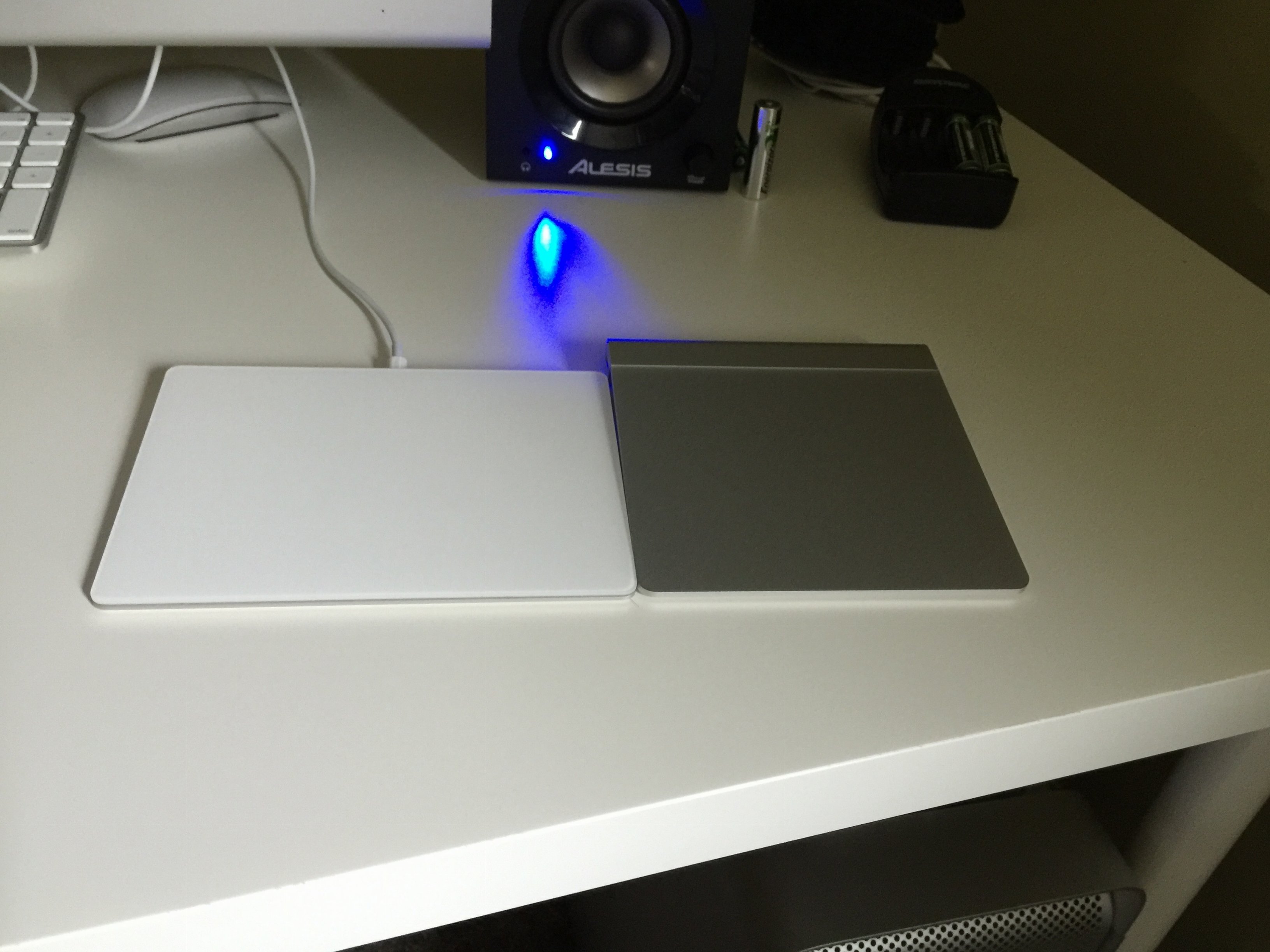

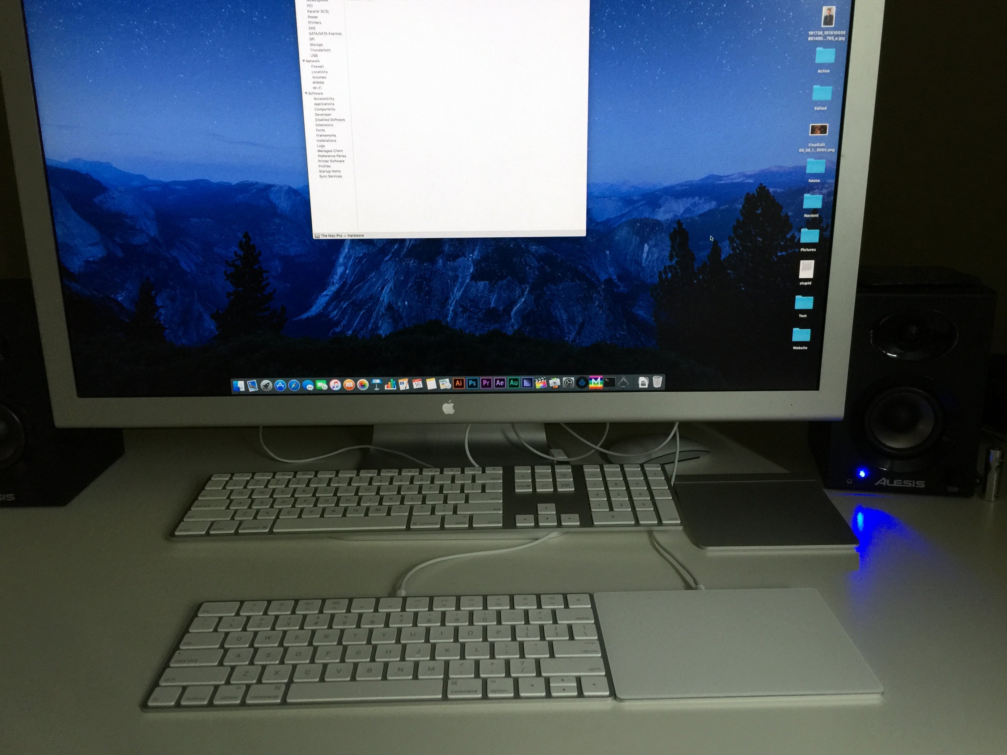

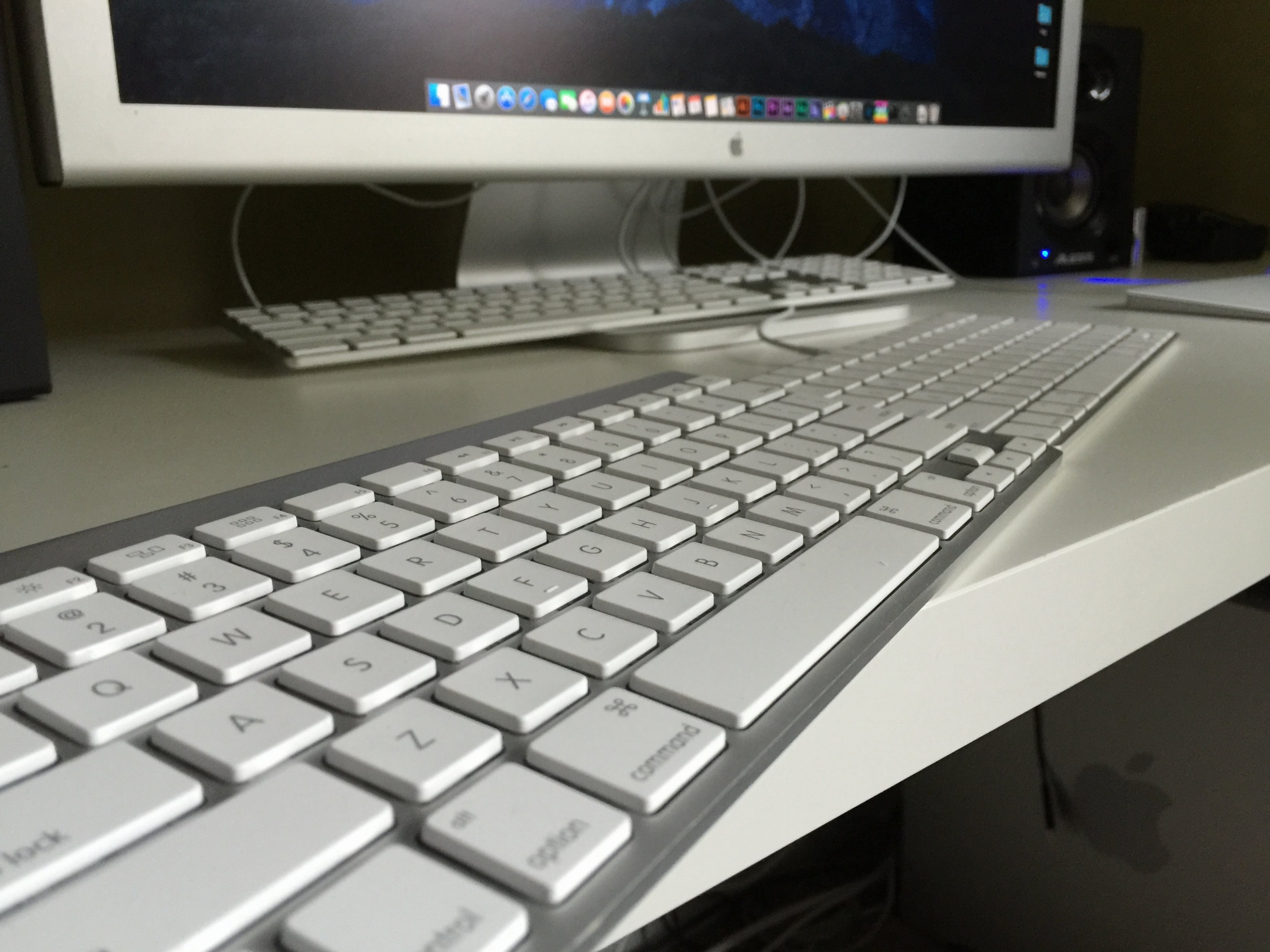

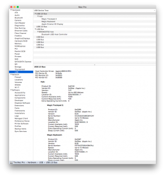

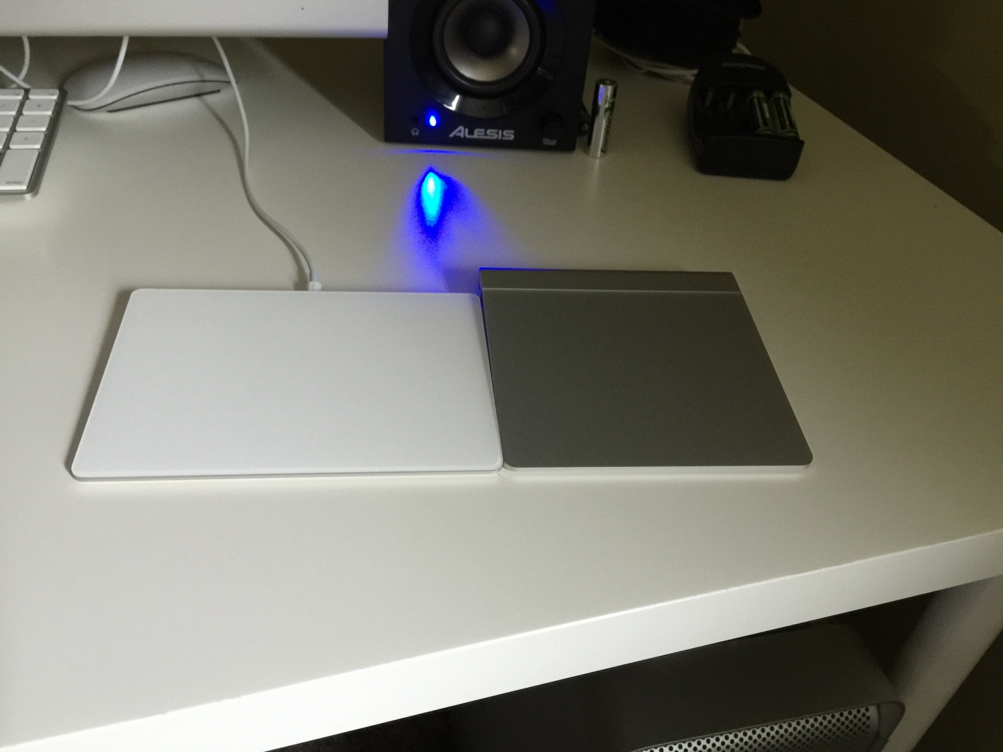

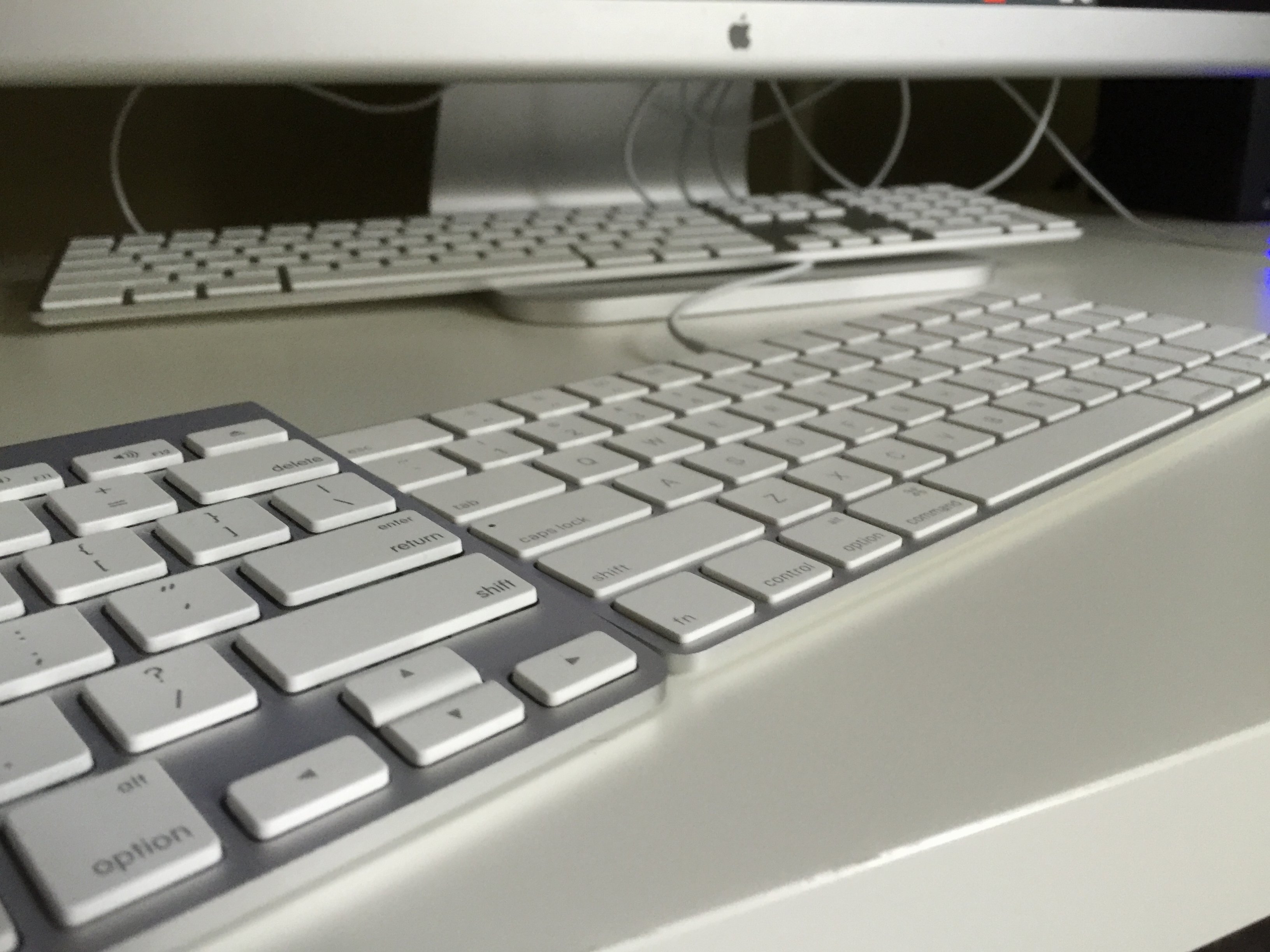

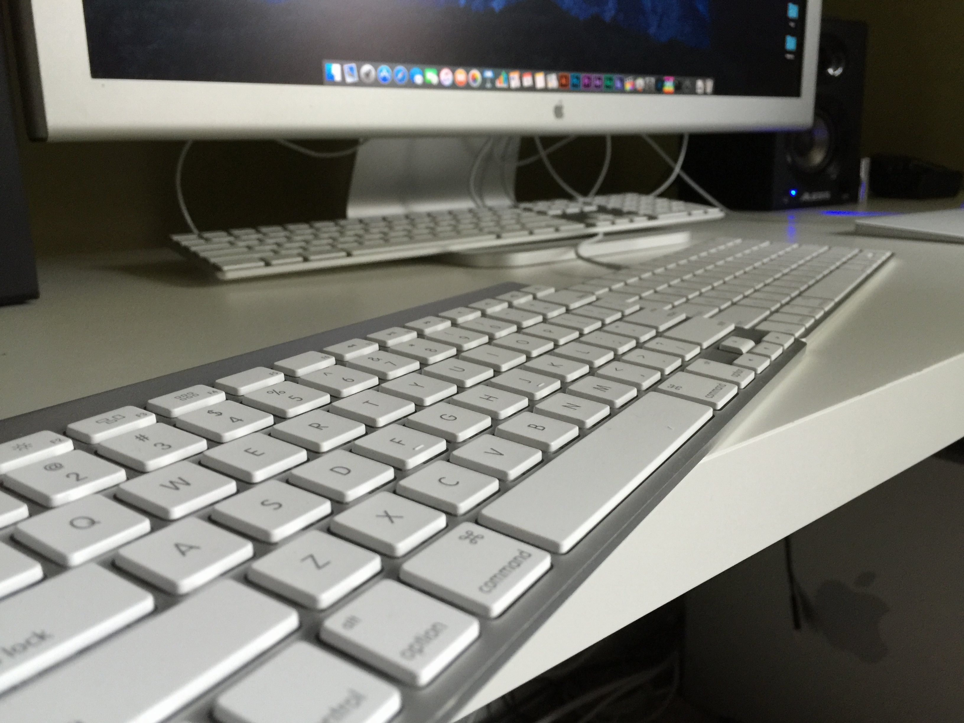

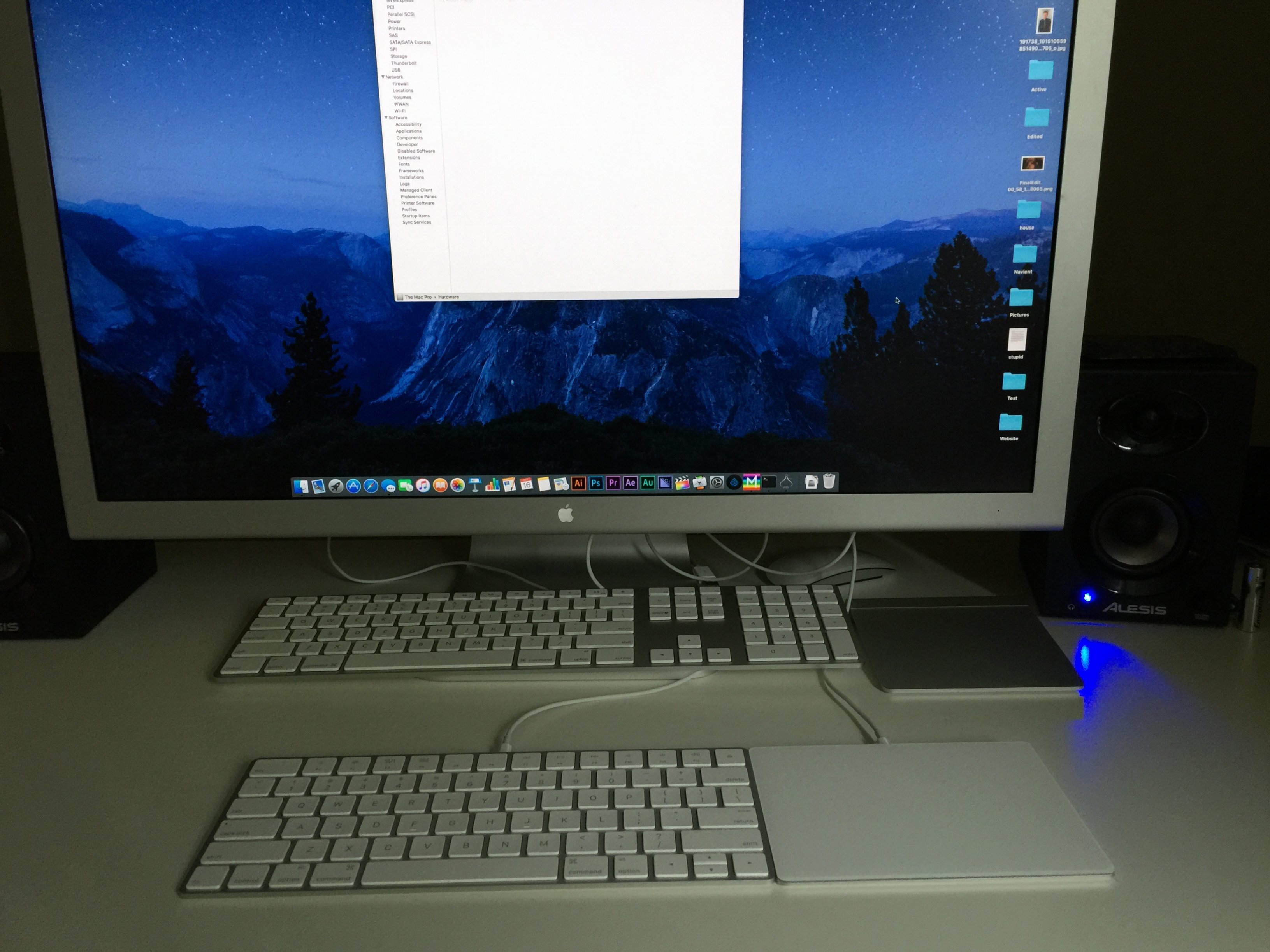

First thoughts: Wow these devices are thin. Love typing on this keyboard. I've been a long hold out on the old keyboard with numeric pad...but this thing is really nice to type on. Both devices are incredibly thin. I was amazed at the difference in size on the track pad. Photos attached (including USB verification, through my 30" ACD hub).

I like how Apple finally understood that flat keys are annoying and uncomfortable. While the new keyboard has thinner keys than before, the fact that they are slightly contoured is a bit reassuring; I like contoured keys.
