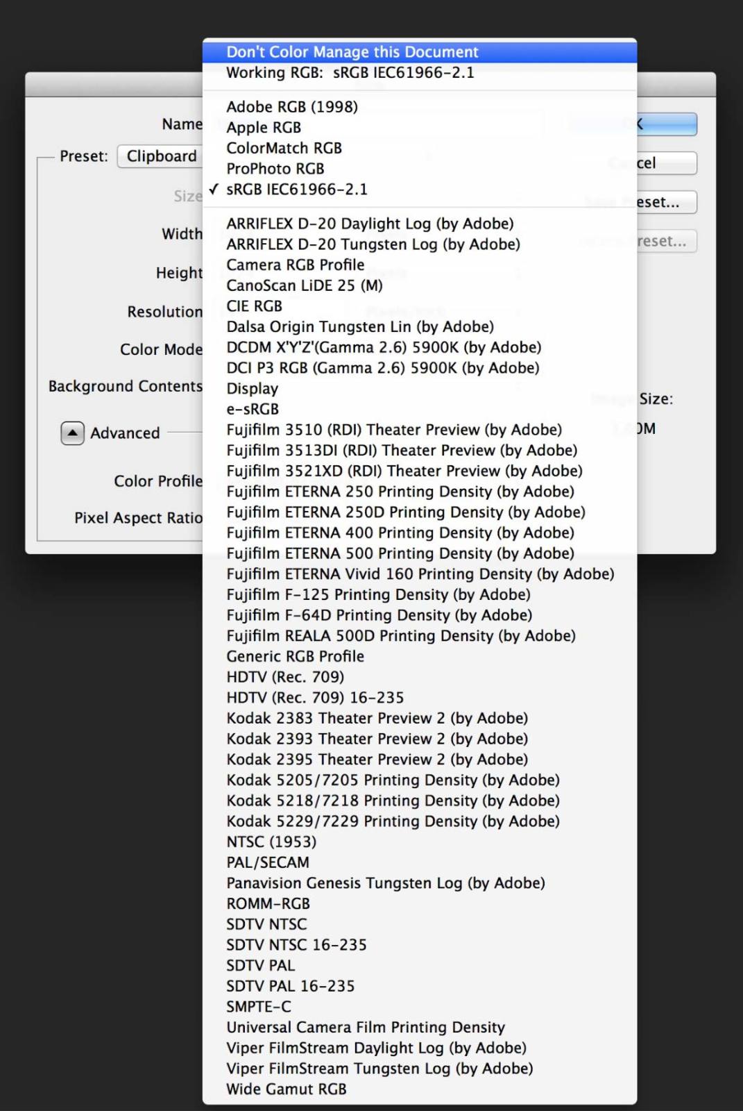

An attempt to find out things...
Almost all the photos I print, anytime, is through photoshop.
The checkpoint is next to (randomly selected?-not by me) the current one.
Do you see any cause of the problem?
Can you suggest the right profile for me?
(it is impossible to test 'n' print with all of them!)
Where are you finding this dialogue in Photoshop?
This shot is taken when you start to create a new image (command-n).
You select dimensions, etc
Ah, OK... I didn't immediately recognize it and couldn't find something similar in the printing dialogues. Most of my work in Photoshop involves photographs already taken, so I don't actually create any 'new' images there.
I'd just leave it as you found it... or even bump it up to Adobe RGB 1998. Unless you know what you are doing, I wouldn't set it to the other choices.
As I said before, the Colour Management is found in print dialogues. Depending on what printer you have and what version of Photoshop the dialogues can look different... but it's there. What are the results to the suggestions I made earlier?
