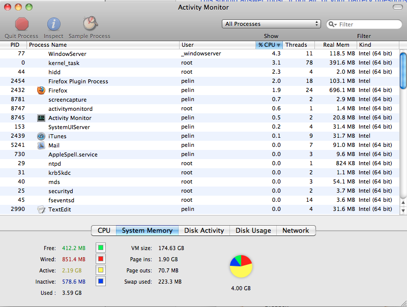

Have a look at Activity Monitor (Applications / Utilities /) and select All Processes and sort by CPU to see what the culprit may be.
image below uses sorting by CPU as an example

attachment.php
