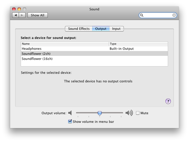

I bought a new Mac Mini (HDMI model) last week to replace an older Mac Mini. I always have to change the Sound Output settings after startup. I'll go to System Preferences -> Sound -> Output and select "Headphones / Built-in Output" because that is how the audio out is connected. However, when I restart, it will be back on "Soundflower (2ch)" every time. The setting will not stay.
Any suggestions would be appreciated.

Try trashing your sound preferences. I had problems with the same type of thing when I first installed SoundFlower, although they eventually fixed themselves.

I was not even sure what Sunflower was. I figured it was a default component. So I searched how to uninstall it and it vanished from the Preferences panel. Hopefully that does it. If not, I will post back here.

Soundflower is definitely not a standard component. It's actually an audio extension from Cycling74 that lets you route sound from one app to the next.
I actually use it in conjunction with LineIn so I can use MacSpeech Dictate on the internal microphone. (MacSpeech does not support that naturally)
I'm a bit disturbed as to how it wound up on your machine.
Thanks guys. This looks fixed. I uninstalled Soundflower.
