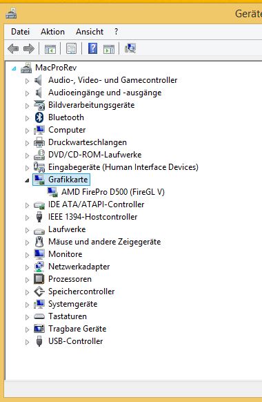

I can't see my second gpu , under GPUZ it tolds my 'crossfire disabeld'
I think the second card is not correct install , any idea ?????

so i have crossfire turned on and in device manager under display adapters, i show 2 gpu's, running the stock amd driver from bootcamp x5640

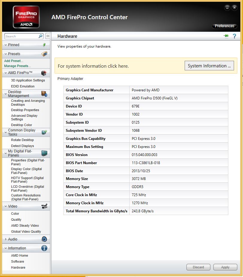

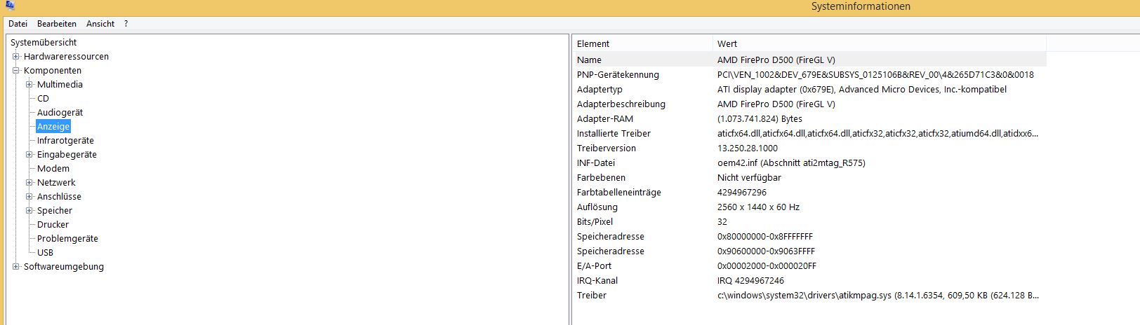

So look at my attach . I make some screenshoot from my system,controllcenter... I think something is damage ?!

I would contact Apple support about that.

I think it is better to stick to the original AMD FirePro control center. Catalyst Center is made for AMD Radeon and HD 5XXXor 7XXX drivers. So, if I were you, I would uninstall all catalyst drivers, reinstall AMD FirePro drivers (configuration panel), and restart the computer. Hopefully, this may solve your problem...
If Device Manager isn't seeing both video cards then you likely have a hardware issue -- contact Apple.
I'd check and see if both cards appear in System Information in Mac OS X before you go sending it back, it may still be some kind of Windows driver issue.
