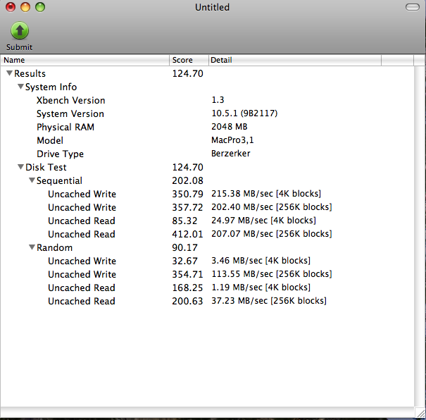

Got my 3.2ghz Mac Pro yesterday (stock ram). I threw in two new Seagate Baracuda 500gb 7200.11 drives and used Disk Utility to create a RAID 0 set (using the software RAID). Excellent drives based on what I've read at Bare Feats.
Attached are my results in XBench. I have to say I'm pretty impressed by these results. Am I right in believing these are good numbers?
P.S. I've been running RAID 0 on my PC for years and know the risks. Backup often...

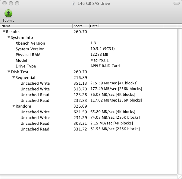

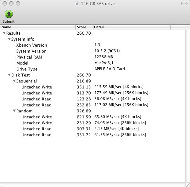

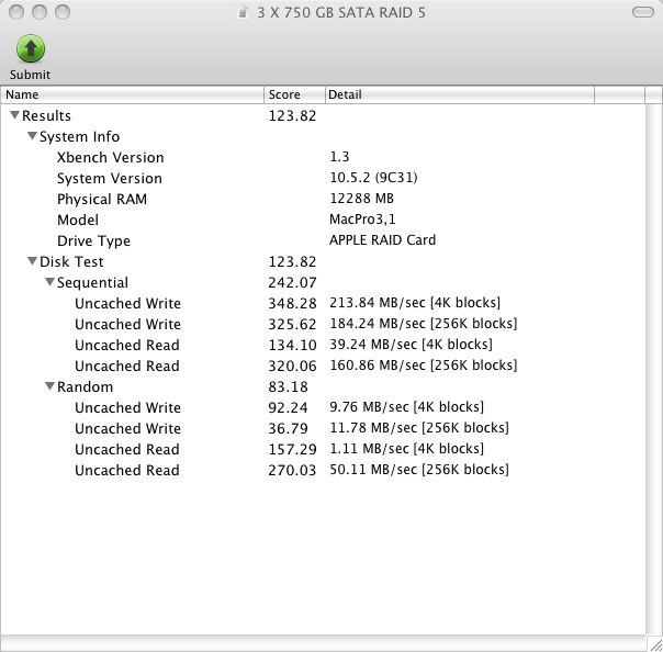

For comparison, find attached Xbench scores for a single 146 GB Seagate Cheetah 15K.5 SAS drive and a 3 X 750 GB Hitachi Ultrastar A7K1000 SATA RAID 5 array, both attached to a Mac Pro RAID card.
To summarize for the text search engines (all scores are Xbench scores, higher is better):
2X Barracuda software RAID 0: sequential score 202, random score 90
15,000 RPM SAS drive by itself: sequential score 217, random score 327
3X Ultrastar hardware RAID 5: sequential score 242, random score 83
What's really killing the RAID 5 are the large block random writes.
