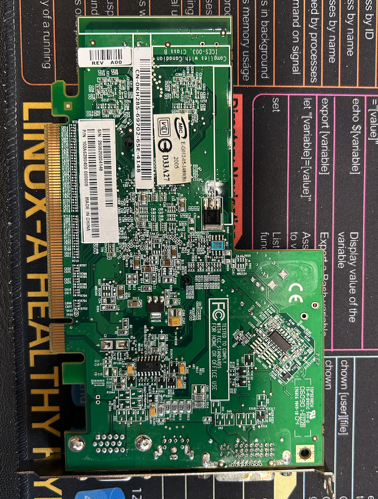

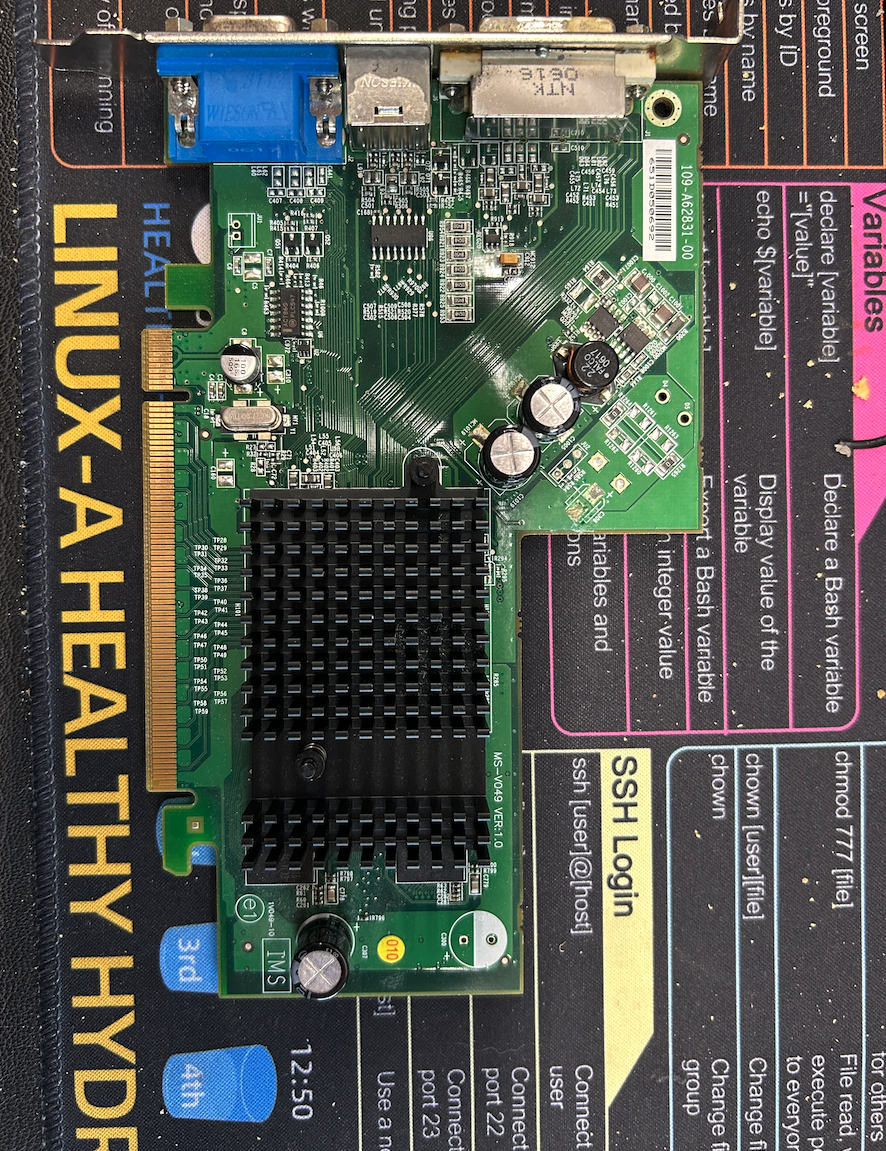

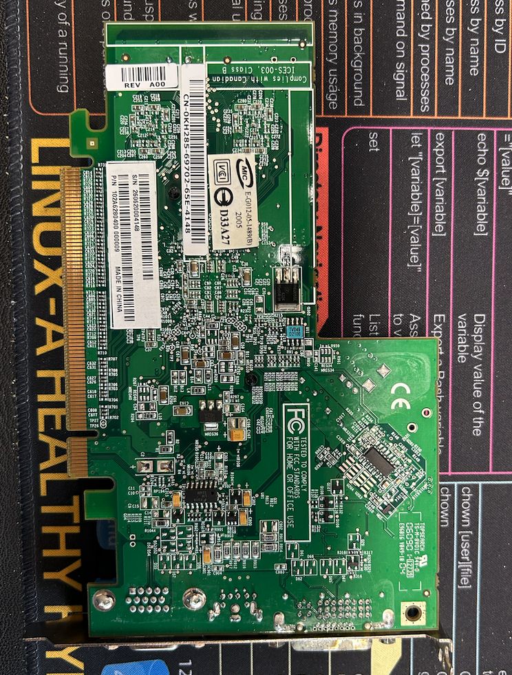

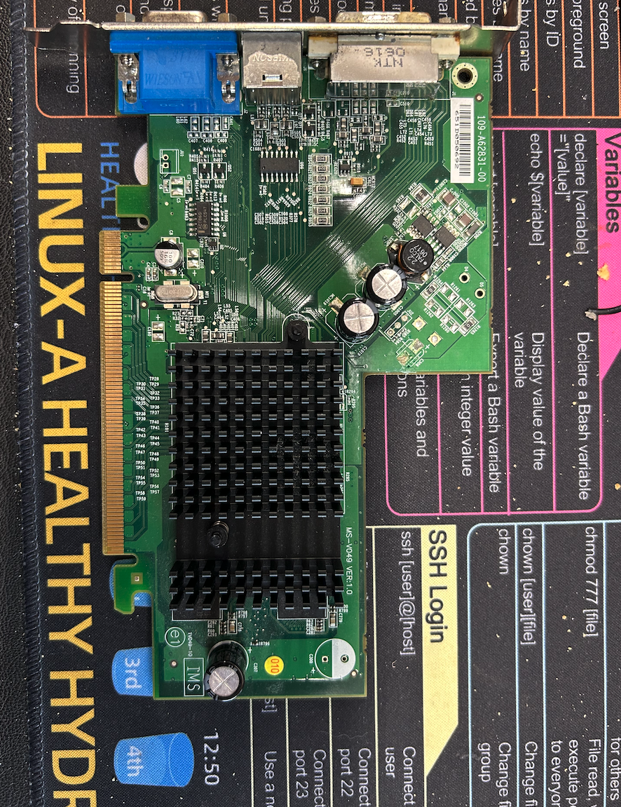

Any idea what this card is? I suspect a "Display card", VGA, S-Video and DVI. None of the numbers seem to make sense as to what it is.
**Edit**
I used Google image and found it is an ATI Radeon X300, complete Poo.

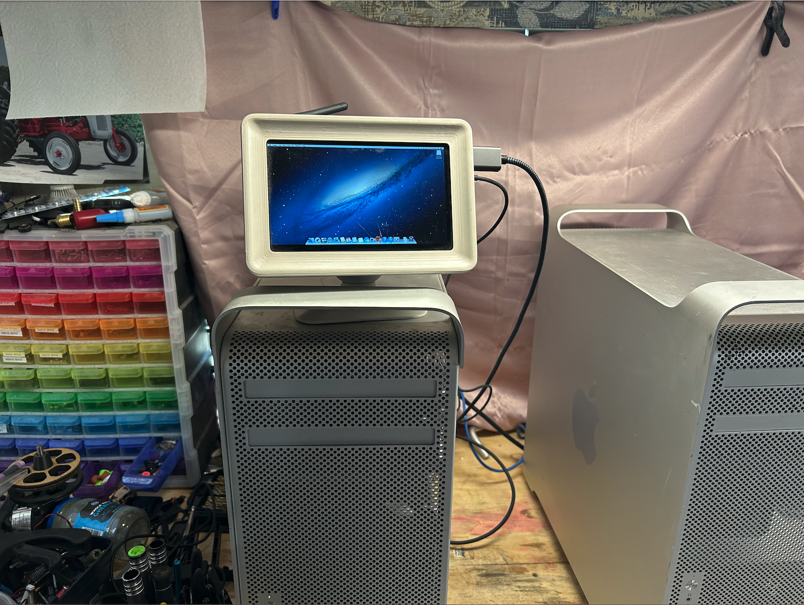

OK, so I DO have an Apple GT120 installed, so the supported GPU issue should be fine.
So, with it being a 4.1, with an AppleOEM GPU, what OS do you suggest I start with?
OK, so now I am really confused. I have tried several GPU's including the GT120 in both 2009 4,1 cMPs and neither will give me any display at all. No output to the screen.
However, I took one of my 2008's and put the very same GT120 into it, same screen, same cable and I got a display. So I wanted to see if it would allow me to pick a boot drive. So I grabbed a HDD out of one of my PC's that has Linux Mint on it, and it booted right up into Mint, no issues. It just worked.
So, what am I missing on the 2009s? I wasn't wanting to have Mint installed, but I am going to celebrate the small win anyway.
Why would the 2009s give me a boot chime, but no display using the very same card that works just fine in the 2008?
Could be anything, corrupted BootROM, spent BR2032 RTC battery, defective PCIe slot, etc etc etc.

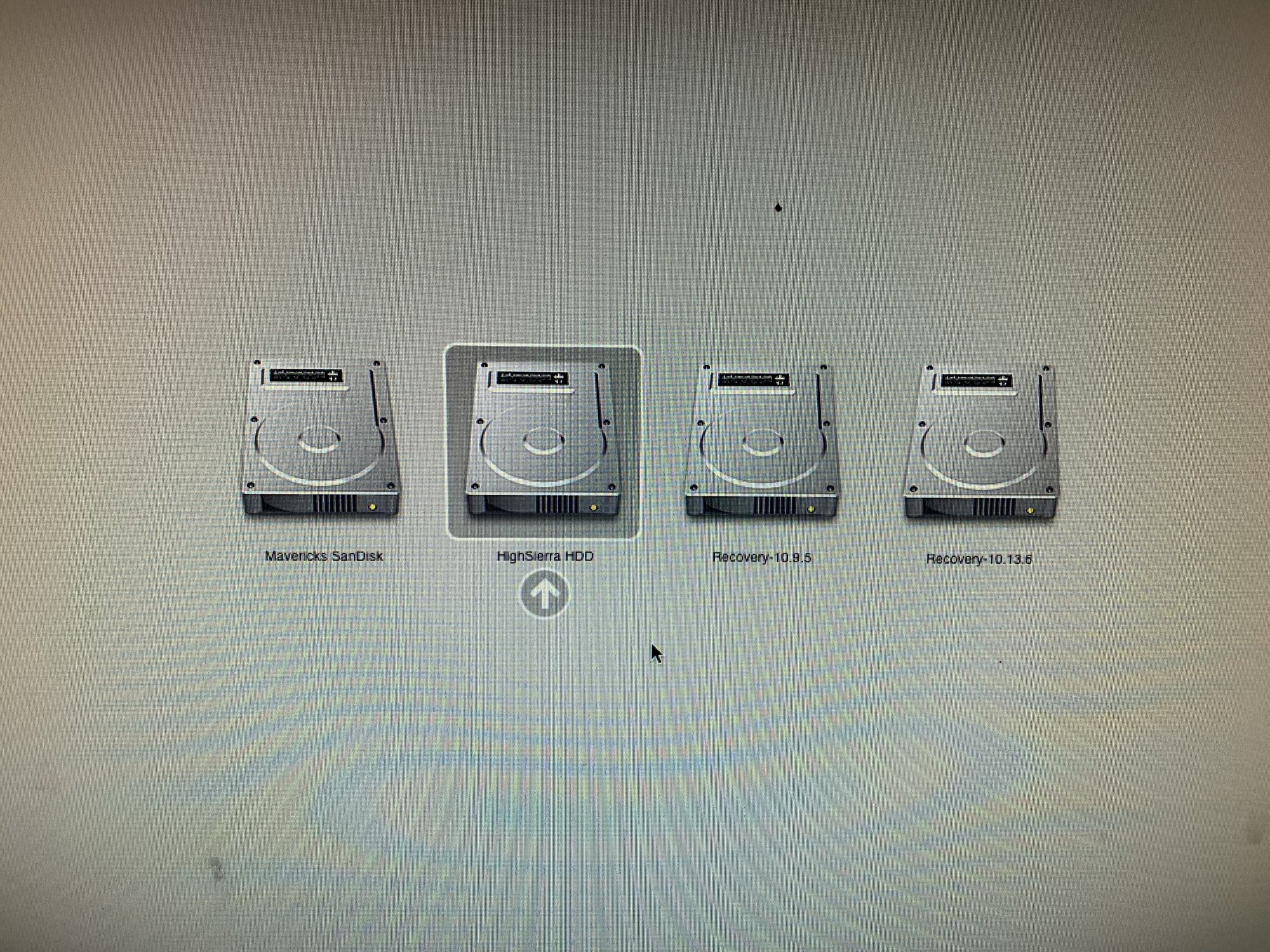

Last night I took one of the 2008s and put the GT120 in it. I turned it on and I got a signal to the monitor. It was just a grey screen, but the output was there. But because I had no drives in it, there was no drive select options.
So, just to see if the Mac would show me an option, I grabbed a HDD with Linux Mint on it.
I put that in and turned it on. It never gave the option of selecting a disk and it booted right into Linux Mint. Everything was working just fine.

OK, so here is where I am at now. I am at least moving forward.
I now have the boot screen back. 2008, GT120 and the screen is just a small RPi screen, but it works. The TV/Monitor may be giving me problems, but this,
while small and upside down, is working.

... The TV/Monitor may be giving me problems, but this, while small and upside down, is working.
Just an FYI, the picture is upside-down because the monitor is mounted upside-down. Once macOS is installed and booted, you can change the screen rotation 180 degrees via System Preferences -> Displays to correct for this. You won't be able to do this during installation, only after you're booted into a full macOS install.
