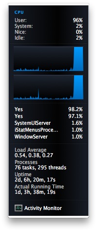

… run the code that forces your CPU's to 100% usage …
Code:
Yes > /dev/null & Yes > /dev/null & Yes > /dev/null & Yes > /dev/null & Yes > /dev/null & Yes > /dev/null & Yes > /dev/null & Yes > /dev/null
x8 becuase there are 8 cores in a dual CPU Mac Pro.
then to terminate all 8 "Yes" processes press "control+C" and enter
Code:
killall Yes

Thanks guys. Just so I'm clear, the tests that Schtumple and richthomas are suggesting are two separate tests? I've run the Yes > /dev/null test a couple of times on my Macbook Air (to show core shutdown) and this test is to confirm that the cores are OK? Kind of like a burn-in/stress test? Also, by doing this, am I explicitly voiding the warranty or anything of that nature?

its the same test. Your MacBook Air is dual core so if you ran "Yes > /dev/null & Yes > /dev/null" and saw no problems then your MacBook Air's CPU is fine. it basically just writes junk data to /dev/null utilising a whole core, so it can be seen as a CPU core stress test.
you are not voiding the warranty of your Mac. its basically the same as fully loading your CPU's cores to encode video, but its just easier.
