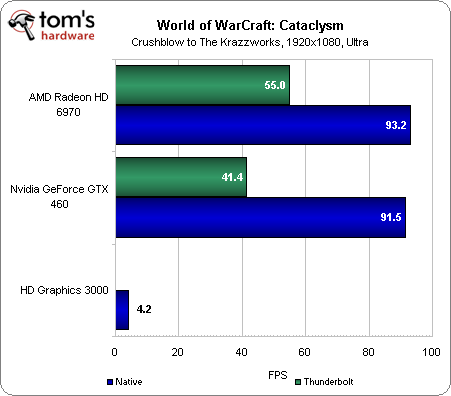

I know we have discussed this article in the past, but it seems like we have all forgotten it. Even on medium range graphics card the difference between going over TB and PCIe is easily demonstrable. I am wary of people claiming to be using a Titan over TB 1 and claiming a 5% reduction. I have to question their testing techniques.... Possibly they were using their eyes?
http://www.tomshardware.co.uk/pci-express-graphics-thunderbolt,review-32525.html
We don't have any such benchmarks for TB2 since we have no TB2 devices, but graphics cards are not going to slow down over the next couple of years. It is safe to assume that trying to upgrade to something beefier that the new Mac Pro will come out with will see you hitting bandwidth issues with TB2.

The complaint was that thunderbolt would provide a SIGNIFICANT performance difference. 5% (as shown by the benchmark in your link) is not a significant performance difference in fact, 5% is less than the standard deviation for a specific card in benchmarks (as per passmark data), meaning it matters more what the temperature, humidity, and if you got a "good" card, than if you're running it through thunderbolt or not.
Said otherwise, a good card, running in a slightly better environment on thunderbolt will outperform a bad card running in a slightly worse environment. Thunderbolt is less significant than the standard deviation.
I've seen all these criticisms as comments by ignorant people on various sites.
I suggest you either read that site or correct your maths.
55/91 is 60% of the performance and the gap is only likely to get wider on new gen cards.
