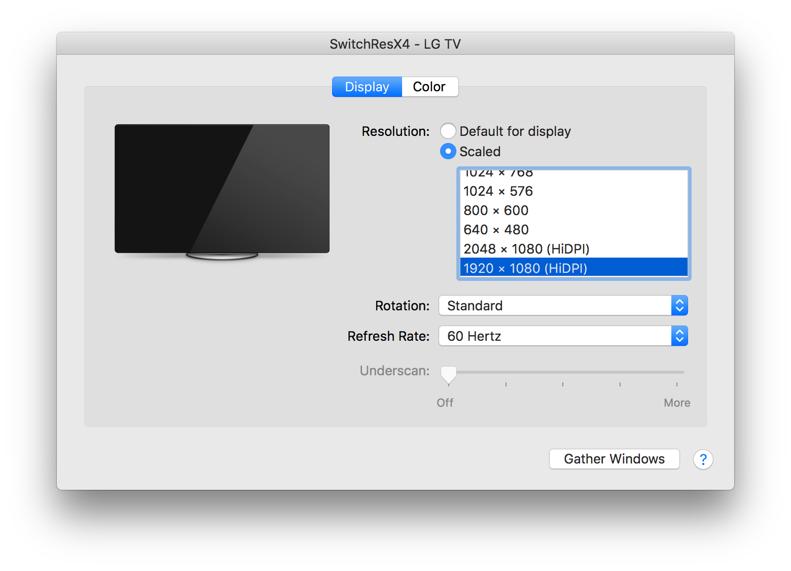

Thanks for the recommendation, I ordered and can confirm I now have 60hz working on my 2013 with HiDPI.
