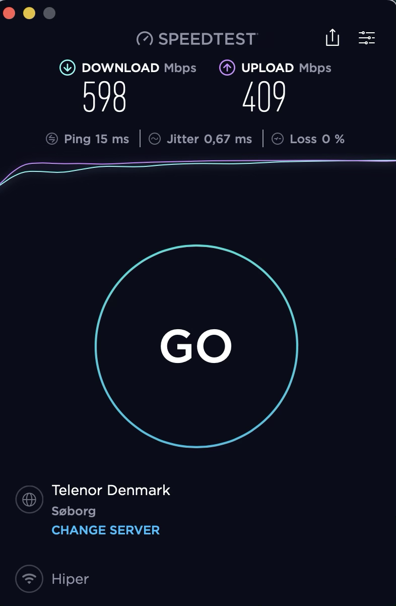

Hi,
What router do you use and is it a M1 MBP? If you can adjust the router setting then ensure the 5 GHz is set to VHT80.
On my new base M1 MBP the Wifi including Wifi 6 is working very well.
Hi,
