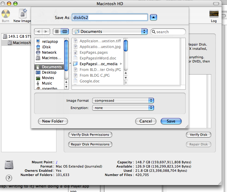

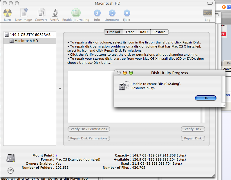

Incidentally, I had tried to activate DiskUtility>>>NewImage - a disk imaging tool part of Mac OS. I got some error screens (see attached illustrations), and I subsequently learned from the Apple forums' folks (not from AppleCare: they did not have a clue!!) that NewImage has to be activated starting with a reboot with the Install Disk 1. Then, apparently, the Image must be sent to an external drive, not the startup drive on board. Anyway, any experience of this??
