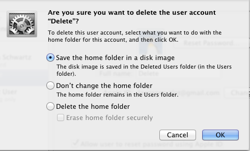

Now that I'm finished with the temporary user account that I created in order to update the OS to 10.7.1, which of these am I supposed to choose now that I'm ready to delete it?
Delete the home folder. Don't worry about checking the box under it.
Yeah, I deleted it. I checked that box though. Don't hurt me.😛
