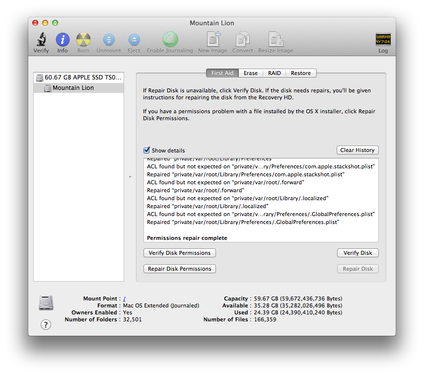

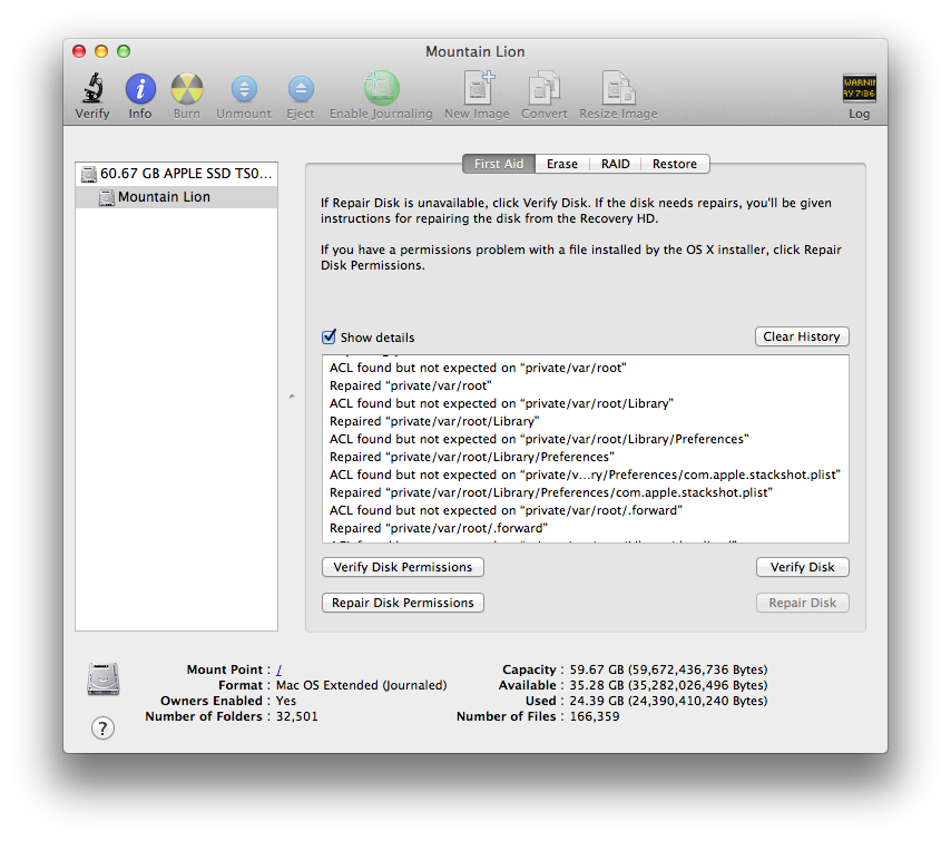

here's the permissions that keep having to be repaired after every restart... I'm not sure how to keep them permanently fixed... any ideas? It shuts down normally if I repair these permissions, but i have to do it again before I shut it down again or I get the same old 15- 20 sec. delay 😕
submitted a bug report to apple through the feedback part of their letter... maybe I'll get a response 😛
