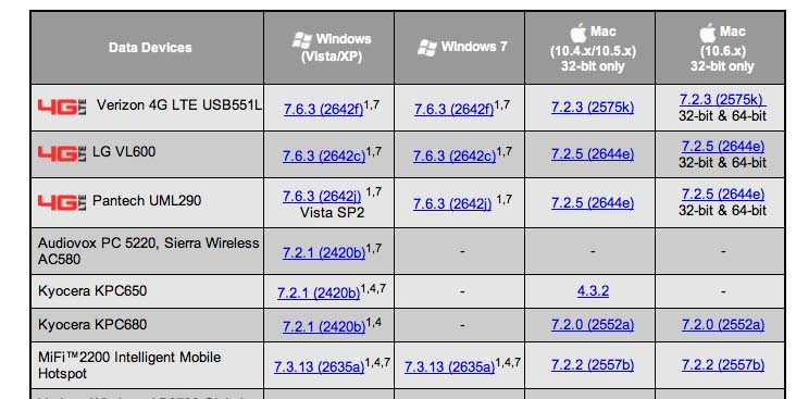

In spite of what Rhyalus said, as of April 21, there's no 64-bit support for Mifi 2200, or any other device at http://www.vzam.net/download/supported.aspx.
Verizon put up a version of VZaccess manager that works with the new MBP 64bit!
Important to note that you need to go to this link to download the new version. Updating from the old version of VZAM will not show a new verison available.
With the updated software my 760 now works fine with my 2011 MBP without booting to 32 bit.
