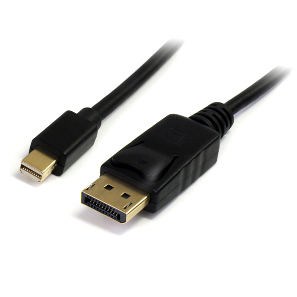

MiniDP to DisplayPort would be easier. Skip DVI completely.
