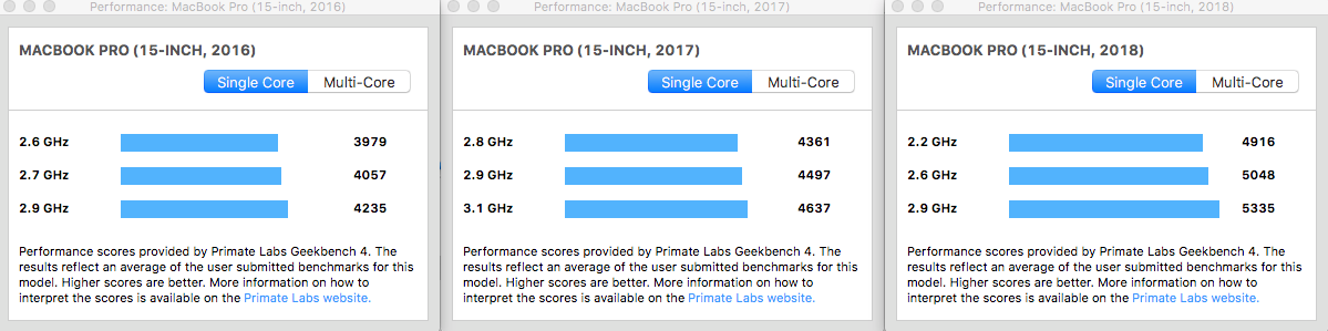

I guess these benchmarks just answered my question. Looks like the improvement in single-core performance of the 2018 MacBook Pro over the 2017 model is even greater than in the previous two generations.

Thanks for your post. It looks as though the base model 2018 MacBook Pro is the obvious choice, as even the highest-end CPU option on the 2017 model is far surpassed in both single and multi-threaded operations by the base model 2018 MacBook Pro.
What's also interesting is that the 2.6GHz 6-core i7 in the 2018 model offers very little benefit to the base 2.2GHz i7, again in both single and multi-threaded ops. The i9 seems to come up with a bigger difference in both, but not nearly enough to justify its high upgrade cost as far as I'm concerned.
