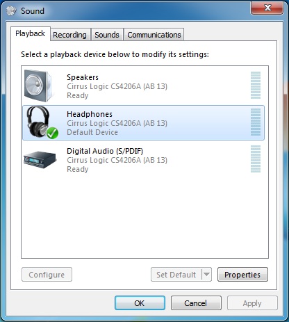

Try this.
Go to the control panel, sound section
Connect your earphones and select the headphones/earphones as default output device.
It works on my 15" i7 MBP
Already tried that but unfortunately it was already set as default.

I have a similar model computer and the same problem. The headphone works in OS X but not in Windows 7 (64bit). Since this is working well in os x, I do not think it is a hardware issue at all. Hope someone is able to report a solution here soon. I can't get my zombie killin on while my wife is trying to sleep.
My comp is the 2010 2.66 Ghz 13" macbook pro. I do not have the red light problem reported by others (no red lights in my audio jack). The audio part listed is the Cirrus Logic one, not the Realtek one.
