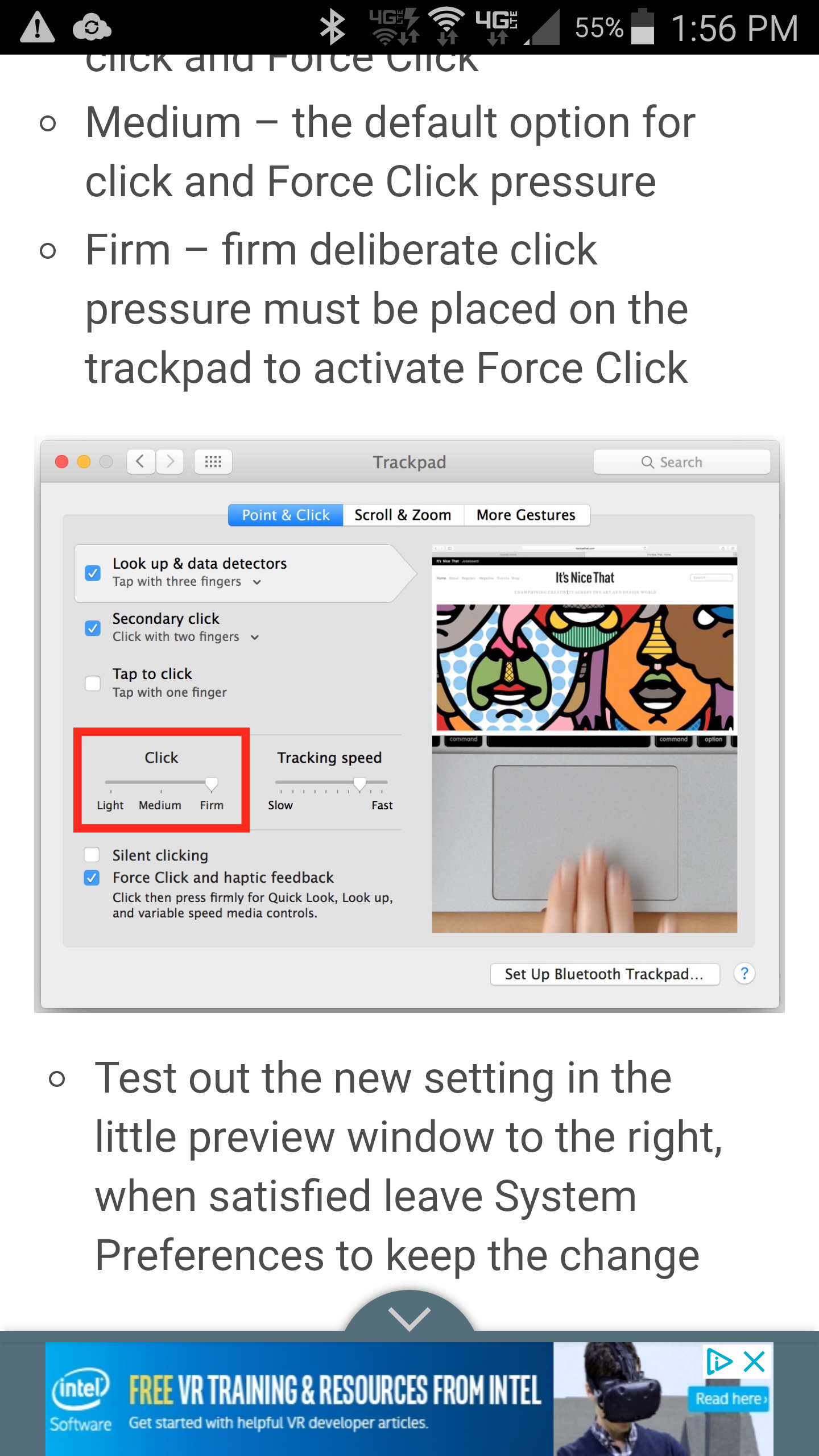

The trackpad needs heavy pressure to work. I went to the trackpad setting and that option is missing. (2013 macbook pro)
Is there an upgrade to get it?
If not what years have this option?
The trackpad should not need heavy pressure to work (although heavy is obviously subjective.)

No force touch on MBPros before the 2015 models.
