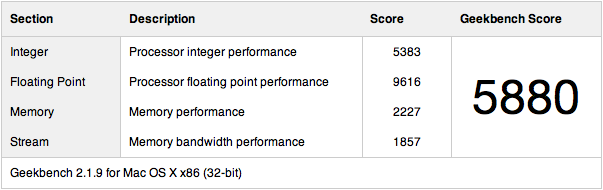

This is the Geekbench result of the new Mac Pro:
I would not complain a bit about such scores. For comparison, this is result from a 2*3GHz Mac Pro 1,1 with 16 GB of RAM:
