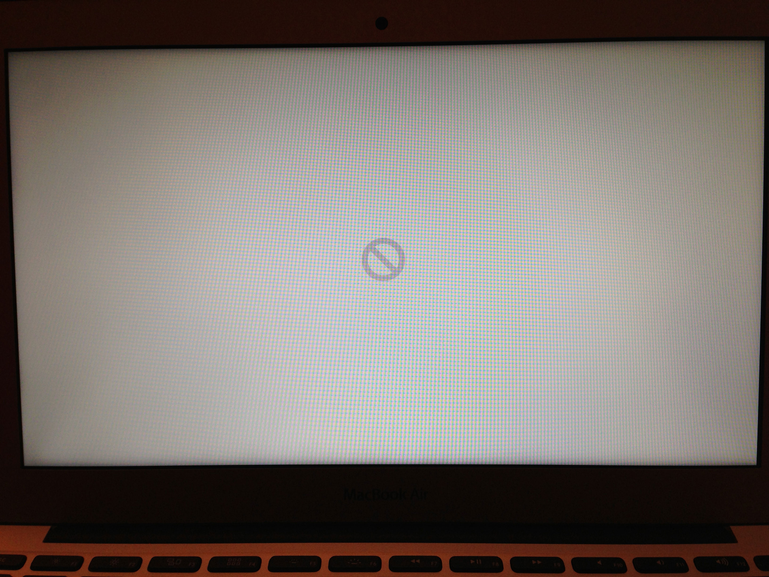

I want to boot from my USB drive to install a fresh copy of Mountain Lion 10.8.4 on my new Macbook Air.
I downloaded the latest version from the MAS, restored the "Install ESD" image to a USB3 thumb drive, and tried to boot from the USB drive by holding down the option key on my MBA.
The first strange thing is that it lists the USB drive as "EFI". I seem to recall that the volume is labeled "Max OS X Install ESD". Anyways, I choose that option, and then the circular symbol with the diagonal line appears.

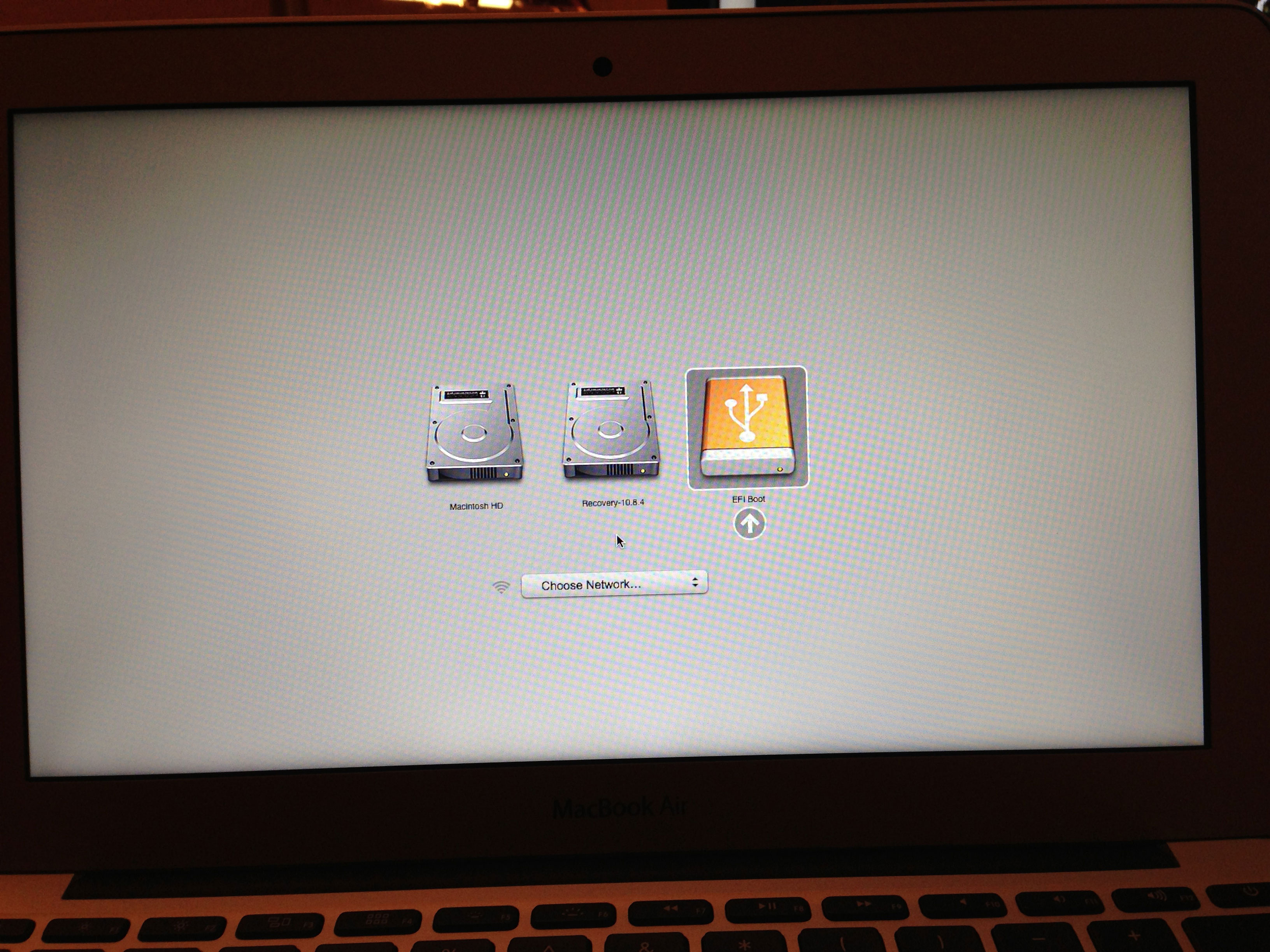

Here's a picture of my 2011 MBA trying to boot from USB
Here are two pictures of my 2013 MBA trying to do the same thing from the same USB drive.

How did you download 10.8.4? From the App Store app? Or via Recovery on the Air? It's entirely possible that the stock 10.8.4 is missing drivers that the new Air needs. Stock 10.8.4 is build 12E55 do you know what build your Air came with?

You cant use the version of 10.8.4 from the MAS, you need to use the recovery partition on the MBA to download the specific version of OSX for that model. (12E55) will not work on the MBA.
Exactly.
The 2013 MBA uses 10.8.4 build 12E3067.
