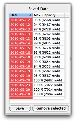

So I checked what cocout battery said and it told me I had 94% capacity on this battery (I mean the battery is supposedly now only able to do 94% of its capacity).
Do you think maybe I calibrated it wrong? I let it drain while I was at work so I wasn't sure when it went off so I waited five hours after I got back from work to plug it in and use it again. And anytime it was powered in I used it (the instructions said I could).
Or should I be worried?

It sounds like you calibrated it correctly. 94% does sound a little low, but give it a week or so of use and see if that number changes for the better. If not I would say you have cause enough for Apple to replace the battery.
after calibrating mine, and checking coconut battery mine was at around 97% w/ only 2 cycles on the battery. FOr somereason now it is at 100% w/ 6 cycles. I would use it a little more and check again later.
same thing happend here.
As it turns out the capacity readings tent to fluctuate.
Take a look at the screenshot. Went down to 94% two times already but came back to (near) 100%. Right now, it seems to stay at well above 100%.
Keep an eye on it and just enjoy your MBP 🙂

Same here. Brand new out the box (fully charge) then install coconutbattery.
11 Cycle on it. with 7weeks old. and 94% only..
After I've done 2 battery Calibrations. It shows 100% 🙂
