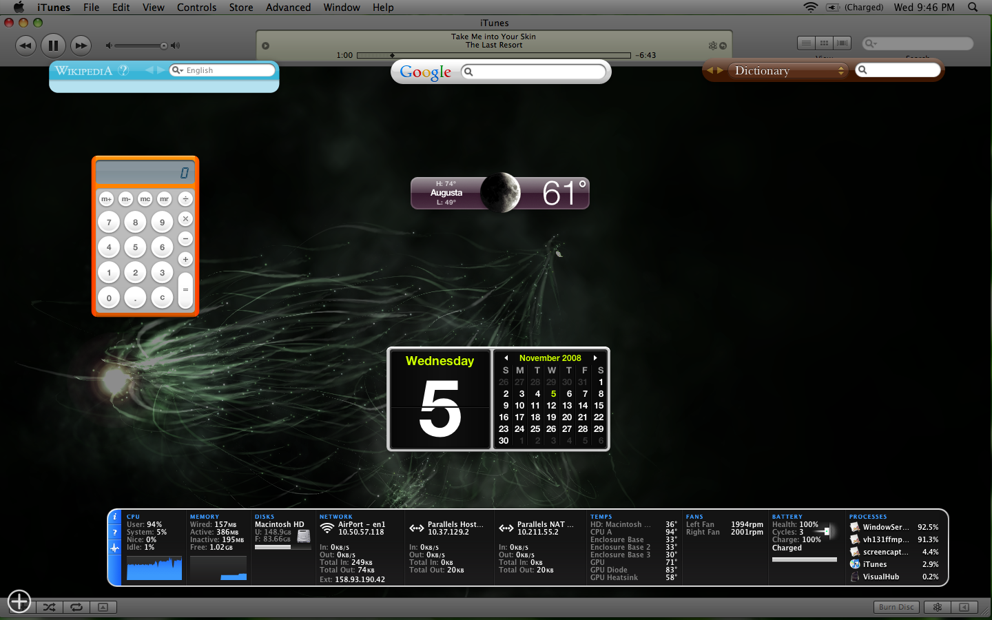

I got to 94 degrees Celsius today and no speeding up of the fans. What is going on? I installed smcFanControl but it was not running at the time. Only ways to get the fans to ramp up was by setting it in smcFanControl

If it's new, return it to Apple. Could be that the fan is actually faulty? If it's the thermo sensor then your fan should be on full, all the time!
The fans aren't completely controlled by CPU temperature only. It's quite possible to get that temperature for a short period of time without the fans speeding up. If your CPU was that temperature for an hour, I'd be worried. But looking at your other sensor temps, I think this was just for a short period.
i mean i had it up past 80 for at least 10 minutes, i would think the fans would be triggered anywhere past 65-70. if it was hardware, i wouldnt have been able to manually boost the fans to 6000. if the temp sensor was bad, then istat pro wouldnt have been reporting such a high temp (which was correct, the case was hot as hell).
Umm.. dunno what your worried about really. The intel CPU's are good till they heat up to 125°C and stay there! I'm not sure about the nVidia Chipset though, maybe they'll cope fairly well too? On the Mac's the nominal temperature regarding CPU's have always been slightly warmer compared to a PC laptop. 65-70°C is still within the normal range.

Thats normal. My MBP does the same. Getting close to 100 deg C, it'll speed up but if it feels like it doesn't need to, it won't.

My MBP does the same too, it'll raise pretty high and the fans will stay at 2000rpm. Makes me a little worried sometimes, but I've never hit anything over 81C.
When CPU load is at 90%, my fans will be on at 3000rpm and the temperature won't go above 74'C. If they go up to 6000rpm, then the temperature won't go above 70'C, even on 100% CPU load. Although I did just get a new logic board, and apparently my old logic board, the fans were clogged up with crud.
I'd take it back to Apple. The fans should definitely come on, even if it is just to 3000rpm.

The new unibody MBPs don't work the same way. I have two and bringing the CPU up to 90% doesn't automatically cause the fans to ramp up. The fans will eventually come on if the heat builds, but it takes a lot more to cause them to come on compared to previous MBPs.

As already answered, yes there are vents similar to the previous MBP body. I do see that it seems more common on this machine for the CPU temperature to run higher, but the other sensors are not high and the case still cool. But the fans do come on if there is enough heat so it's not broken. Unless I looked at the actual temperatures, the MBP feels like it runs much cooler than previous models.

has it been clearly stated when the fans will start to spin up?
because mine never left 2000rpm even at temp above 80C for long period of time (more than 5min) when converting movie in isquint.
Not until i installed fan control.
