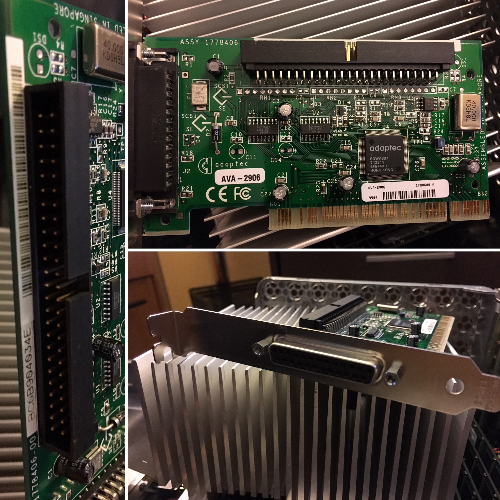

Only a 25-pin connector on the SCSI card, so it's likely low-speed card intended for scanners and ZIP drives etc. Card likely doesn't have HDD support. Adaptec 2906 possibly...
Can you get a better photo of the SCSI card?
Reactions: 1042686
Only a 25-pin connector on the SCSI card, so it's likely low-speed card intended for scanners and ZIP drives etc. Card likely doesn't have HDD support. Adaptec 2906 possibly... Can you get a better photo of the SCSI card?
You're right. It is an Adaptec 2906. This was originally in a photography gallery so a port for a scanner or printer makes complete sense but why then does it have an internal port for a cable if it was to be used only for external peripherals? Was it for linking multiple Scsi PCI cards together or something like that? Maybe an internal zip drive?

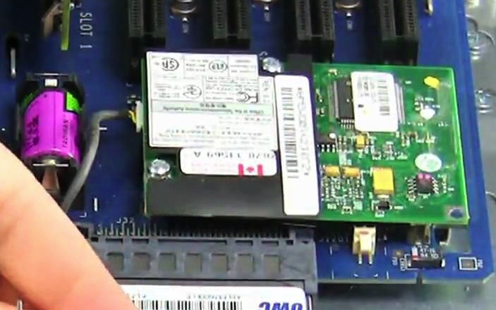

Thanks for verifying, Xapher. I have another question (full of them this morning). What is this card for? Is it Bluetooth? It is missing on my specific MDD but I saw the mounts, port & cable for it and was curious. Thanks a bunch.
That would be a modem card, today they aren't needed cause of broadband connections, but if you used dial-up, that's how you would connect to the internet
Ahh, makes sense why it's gone. I contemplated a 56k modem considering the age of the MDD but was not sure. Thanks for clarifying.
A 50-pin internal connector was typically used for optical, ZIP, Jaz, Syquest or tape drives. All of which are fine on a 10MB/sec bus. Factory option for SCSI HDDs at that time would been Ultra SCSI at 80 or 160MB/sec and they use a 68-pin connector..

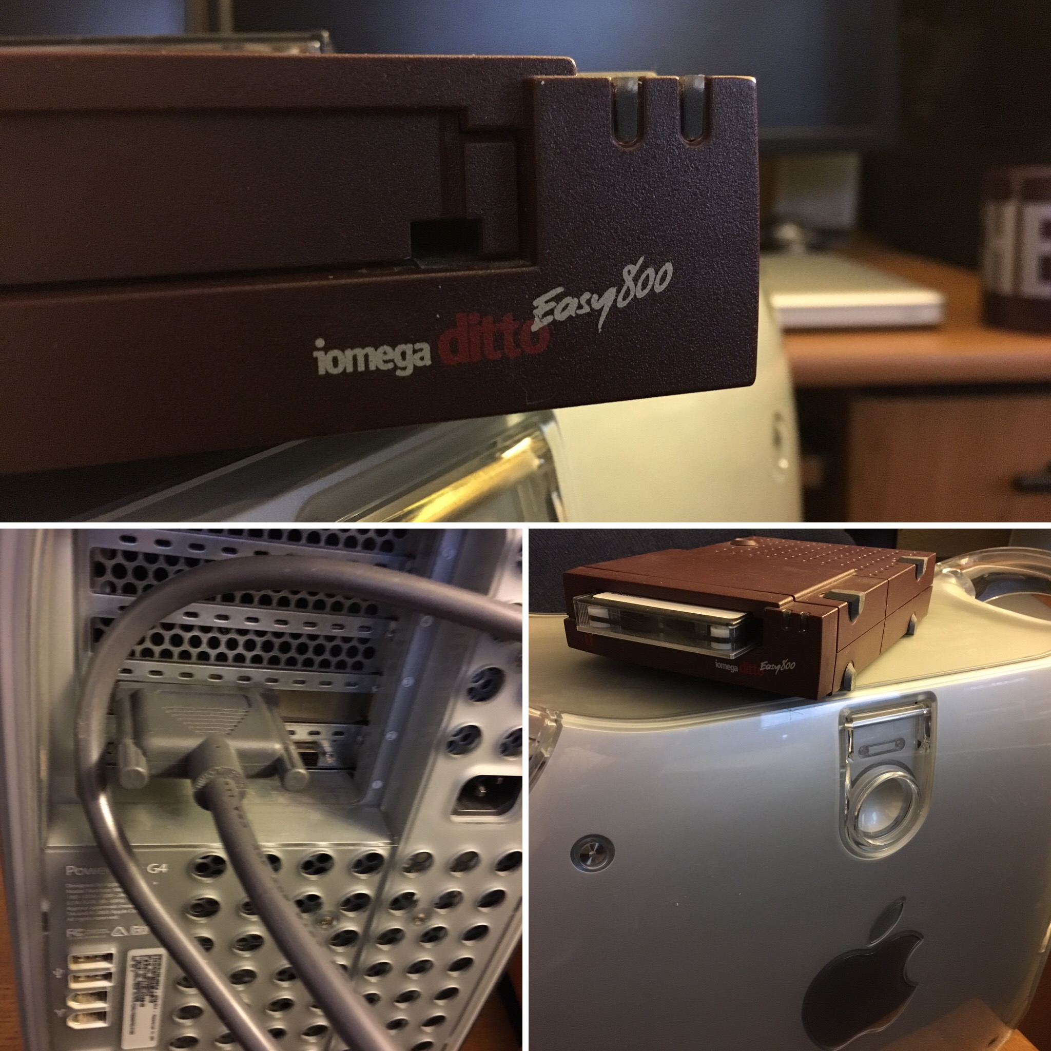

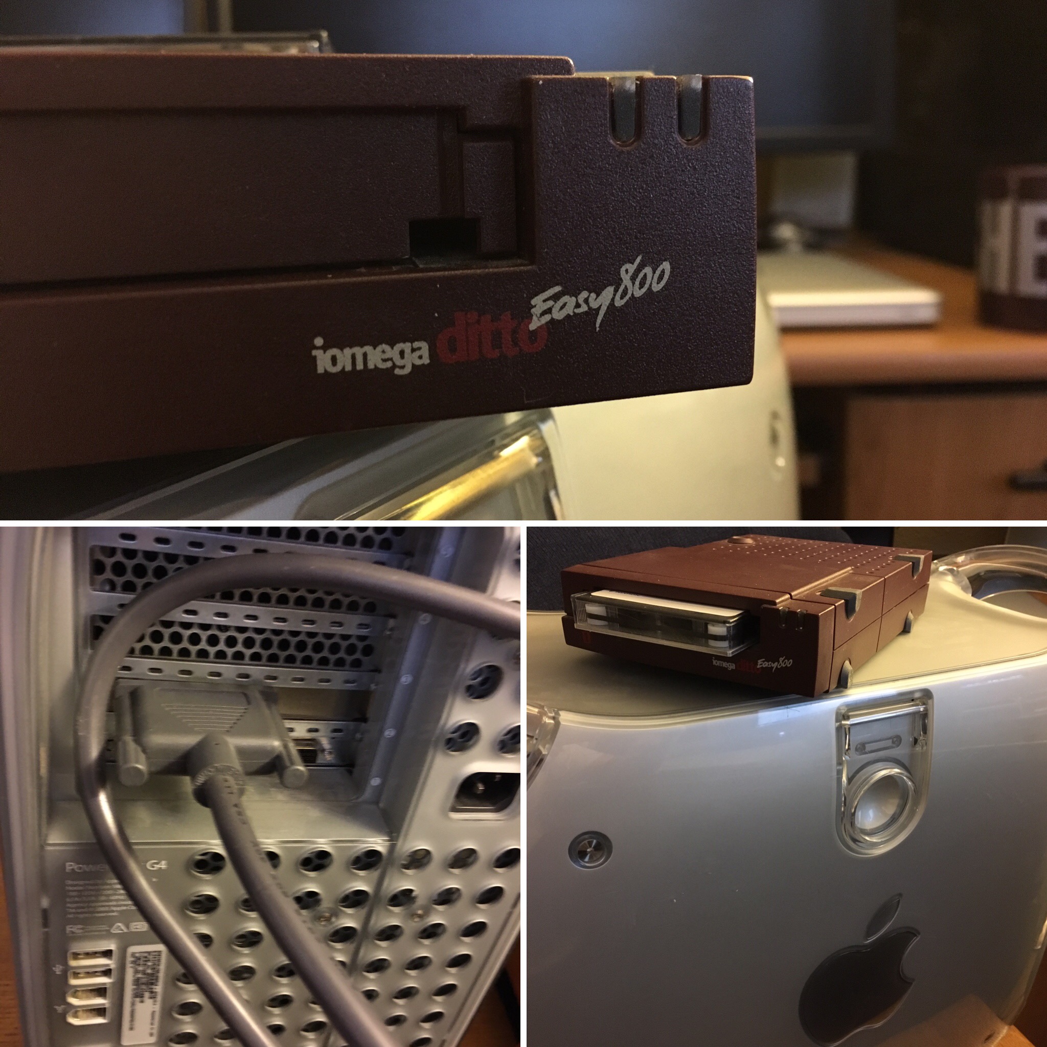

The Ditto was a tape drive for archive/backup. Travan tapes I think, 400MB each. The 800 refers to "compressed" data as they assumed 2:1.
Predates the MDD by a good few years. We sold them at my then work around 1997/1998.
Reactions: eyoungren

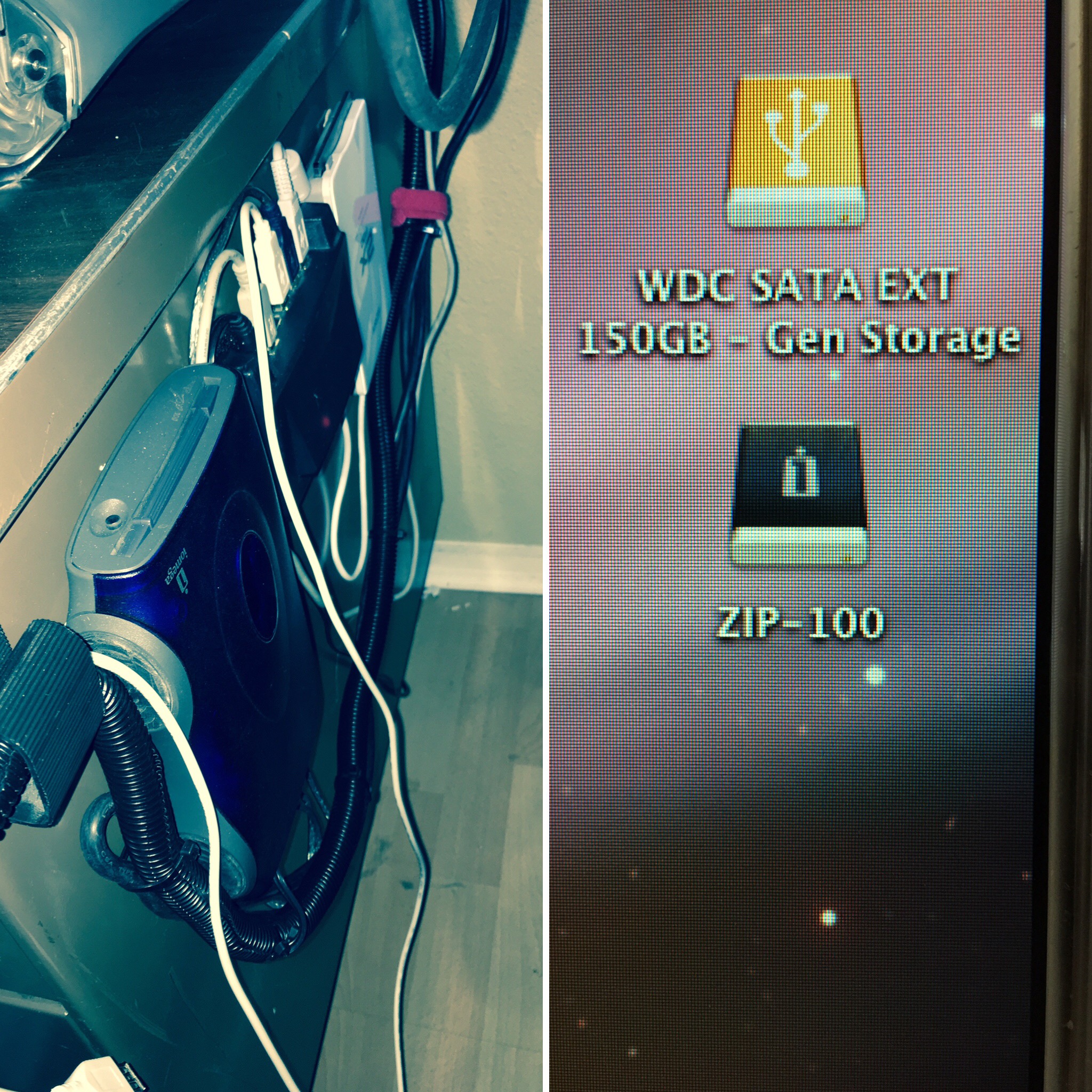

I have an external zip100 connected to my QS. I have it velcroed to the side of my desk next to a 1.44mb external floppy drive. I found a cool icon for it too so it doesn't use the generic white osx one. I've had it ever since late 97-8ish when the basic webdesign electives I was taking at college req'd it - the schools classrooms & labs all used them. That weird time between 1.44mb floppies and CDRW dominance I guess.
