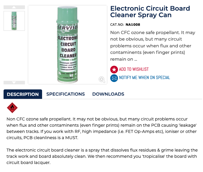

1st Question - I want to clean the ports & the anywhere on the logic board that could use more than a blow/brush - can I use this cleaner safely on the ports & logic board?:

1) To do a proper cleaning for all parts and ports, I would completely disassemble the MacBook and use pure isopropyl on all affect areas. Don't use excessive pressure or alcohol and allow everything to thoroughly air dry before reassembling.

To your point about cleaning, I've worked on a couple of 2011 MBPs as well (which are identical to the 2012 internally I believe), though to be honest that doesn't really matter; as the previous poster recommended I always use isopropyl alcohol - this is it but there will be similar products nearer to you.

1. Another vote for Isopropyl Alcohol. I use 90+% on electronics. Just don't get one that is moisturizing.
