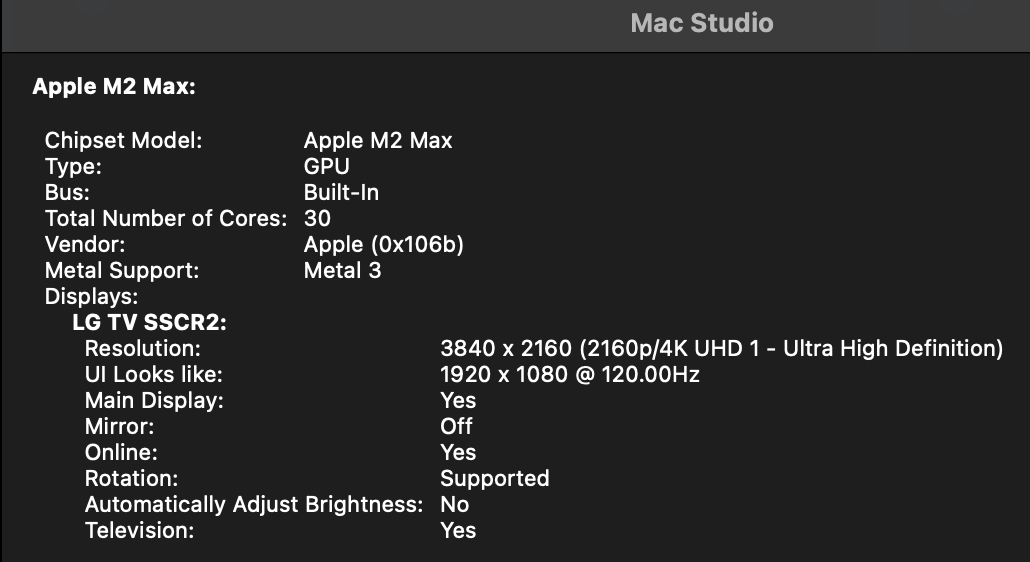

I'm intrigued and terrified at the same time by this. Can you share a photo of your setup? How heavy is that 42" TV? What's the screen size in pixels?
I could in a bit, still rearranging and cleaning things in the home office. A lot of people are using the LG C2 and C3 42-inch for a monitor, because it is excellent and cost-effective. If you search Utube or others, you'll see tons of videos and reviews. As for screen size, below is the system report I just ran for you for GPU/displays.
