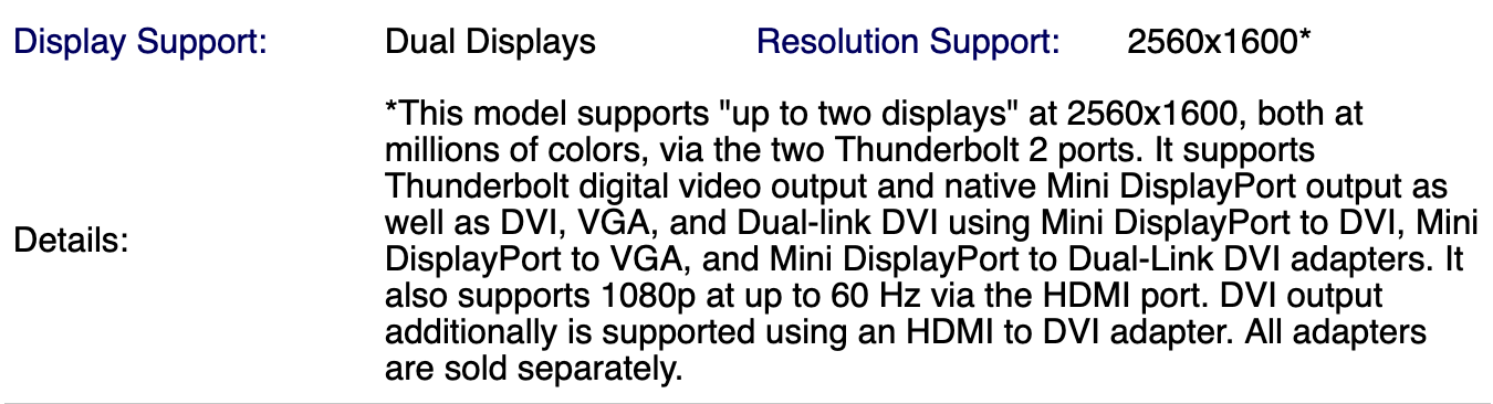

My concern is about resolution, I believe my 2014 Mini can afford 2560x1440 through HDMI, is that correct? I am evaluating a refurb Benq among either an EW2780Q, a PD2700Q or a PD2500Q, this latter one being 25" diagonal.

That's not the way I understand it.
From everymac.com:
If you're going to get an M2 Mini in the future…and plan to use whatever new monitor you get now with it…I'm wondering why you shouldn't go ahead and get a 4K monitor to run at 2560x1440.
