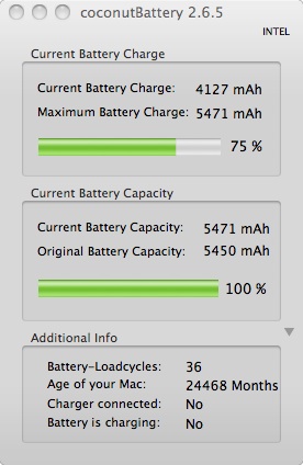

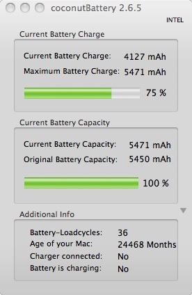

Patrick J macrumors 65816 Original poster Oct 16, 2009 #1 After my mac shop swapped out the mobo in my macbok pro, coconut battery shows Battery Age: 24468 months? How can I get back to my good old 2 months? Attachments Battery.jpg 50.1 KB · Views: 145
Eidorian macrumors Penryn Oct 16, 2009 #2 Reset your PRAM and SMC. It's always a good idea after new hardware is installed.
Patrick J macrumors 65816 Original poster Oct 16, 2009 #4 Still showing 24k months after SMC and PRAM reset
Eidorian macrumors Penryn Oct 16, 2009 #5 New logic boards will screw up plenty of reporting software. Is your serial number even showing up in System Profiler?
Patrick J macrumors 65816 Original poster Oct 16, 2009 #6 How interesting, it comes up as Serial Number (system): System Serial# as in no serial number EDIT - after some googling I found out that the Service Center has to set the serial number when changing the mobo. Will phone tomorrow about that
Eidorian macrumors Penryn Oct 16, 2009 #7 Yeah the out of the box logic board is the only one that is going to work right. Anything new that's installed is going to be screwy.
